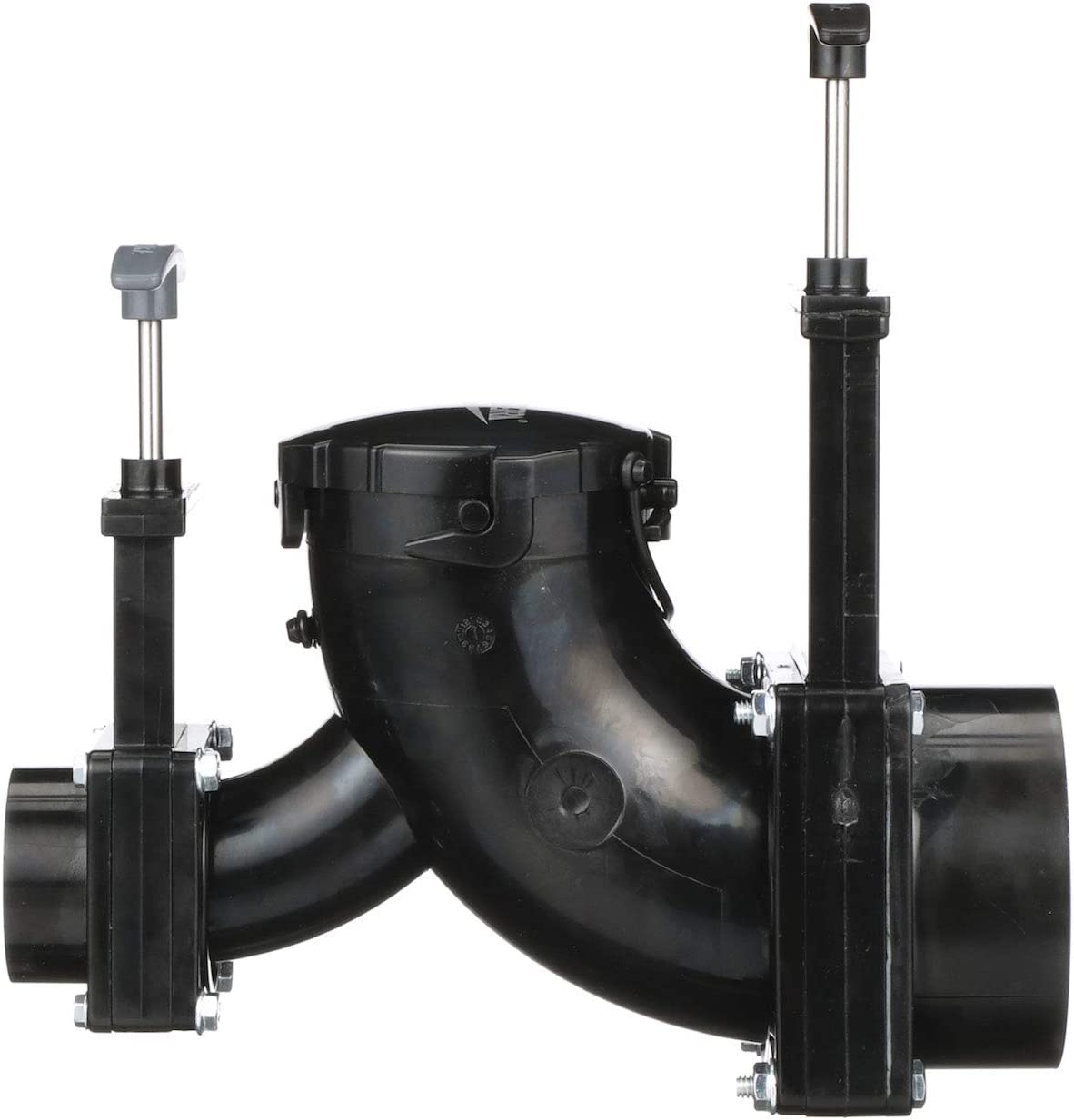

@ExpoMax
I need a favor bud, can you tell me if this piece with the arrow can be purchased at a typical RV store? Does this thing have a special name by any chance? My GF's Casita needs her pipes to improved and I need this thing.
I'm curious did you change the drain pipe config from the pic below to something with higher clearance? If so, can you put up a pic pls?
Thanks.
@ExpoMax
Thanks.
You can see what I did in the pics above in this thread. I also have no idea what that is called unfortunately.
Oh SNAP, thank you bud 🙏
