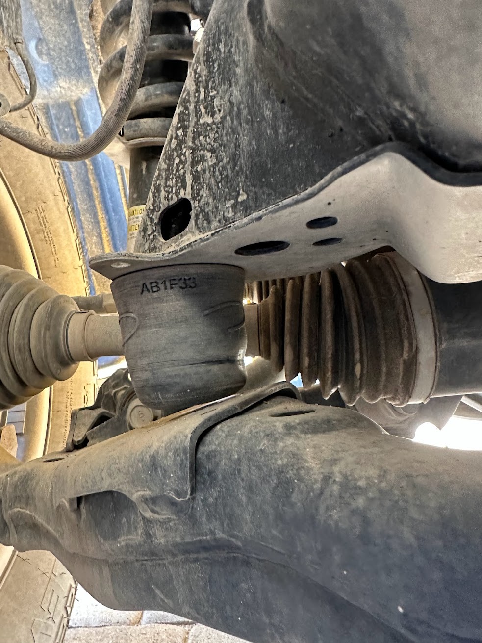

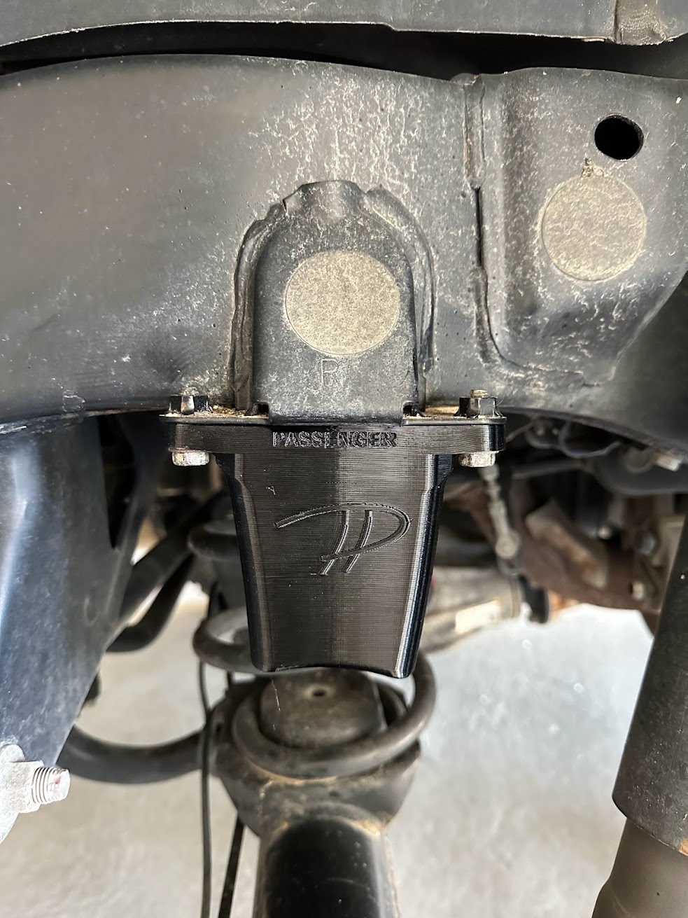

I had the first gen bump set from him for a 460, unlifted. They're super progressive and comfortable, and had the fronts on for a year before I swapped back to OEM to do some testing. For stock height, he makes a shorter one. Otherwise they are basically continuously engaged and start to deform.

I would. They are cheaper than the comparable alternative (Durobump, Timbren etc) and were super comfortable when I had them. I just need to get them back from my friend and put them back on. I can't comment on longevity, but the type of material that's used seems to be durable. It's also not an area that has a lot of direct UV exposure which is what I would worry about the most.

I'm pretty happy with the front set. I'm not sold on the rear. I don't feel the same progression out of the rear set and I think it's due to the design. It is really flimsy on the mounting location with "a lot" of side to side movement. I feel it could benefit from a more rigid base. I contacted Perry and was told it is like this by design.

Hey, I totally respect the concern about side to side movement. We recently added a simple graphic on the website to explain the design intent. There's a failure mode with a competitor's product that I'm trying to avoid - essentially, the rigid mounting base appears to force their bump stop to buckle and fold over. By having our bumps flex at the mount, they're intended to align with the axle.
