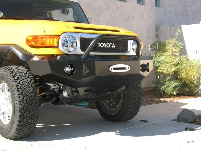

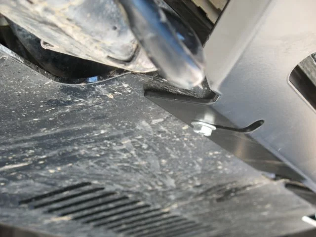

Next, install the lights and the front skid. James said to install under the Bud Built Skid, but over is only the way it'll work. I haven't installed t he side frame supports yet, but whill do the tomorrow when I install the winch - I need help with that and had to install the bumper to transport it;) .

That is the best looking FJ bumper I have seen to date!
Now I must buy one. Thanks for the install pics.
Looks awesome. Can't wait to see it in person.:cheers:

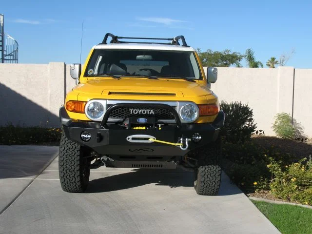

Thanks - FJ40LVR and I installed the winch this morning - I'll post pics as soon as I take some.
For anyone installing this, a ratcheting box end 14 mm wrench is worth the investment if you do not have one. Also, install the side frame support brackets before installing the skid plate - leave skid plate for last.

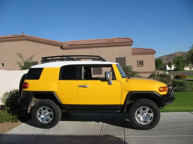

OK - here are some final install pics. If anyone has any specific questions, post or feel free to pm me.
