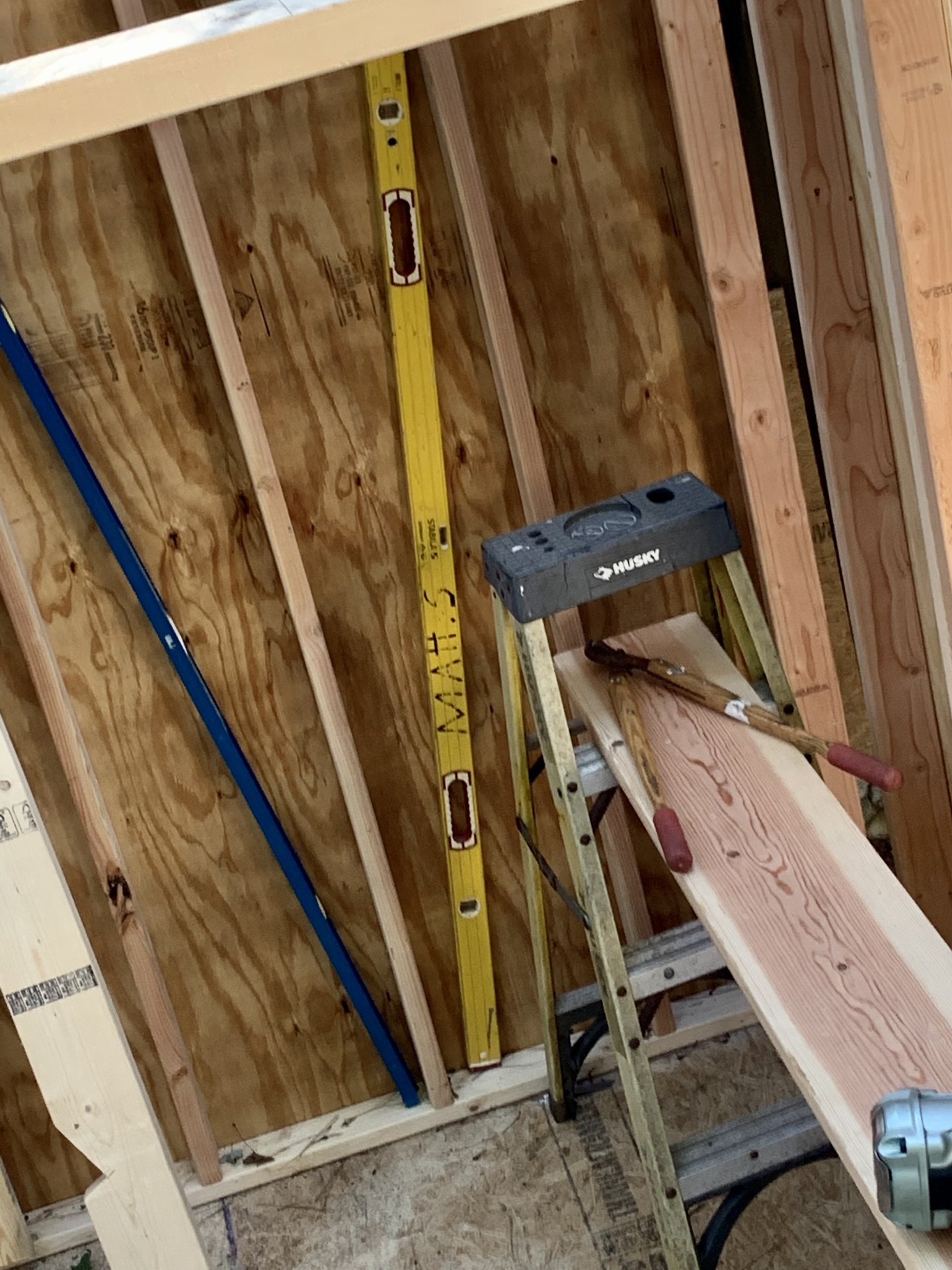

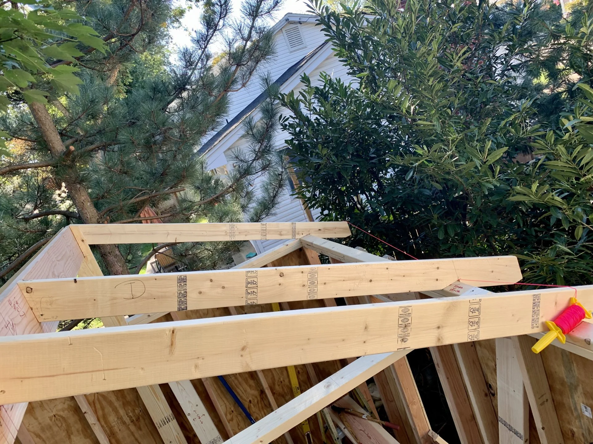

Framing the roof had taken shape
Wow 😮
I forgot what a mother aerial stick building is !
Roughing in the active operation skylight per FSM specs exactly to the Letter !
OBEY the FSM. !
View attachment 2817512View attachment 2817513View attachment 2817514View attachment 2817515View attachment 2817516View attachment 2817517View attachment 2817518View attachment 2817519View attachment 2817520
The TEQ sticker in the first pick reminded me of "Kilroy was here" for some reason. lol Nice progress!

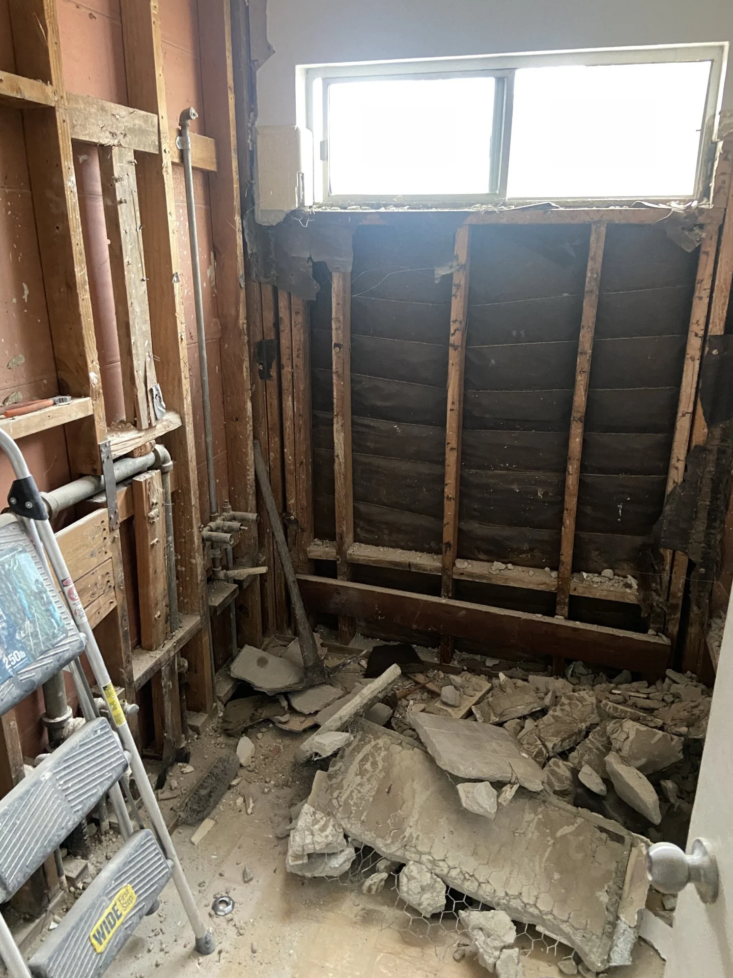

Gutted the bathroom of our guest house to replace 60 year old galvanized with a complete new copper supply and add new plumbing for an outdoor shower.
Aaaaaaaaaaargh, two of those damned things have just been wrapped up here (no outside shower though).

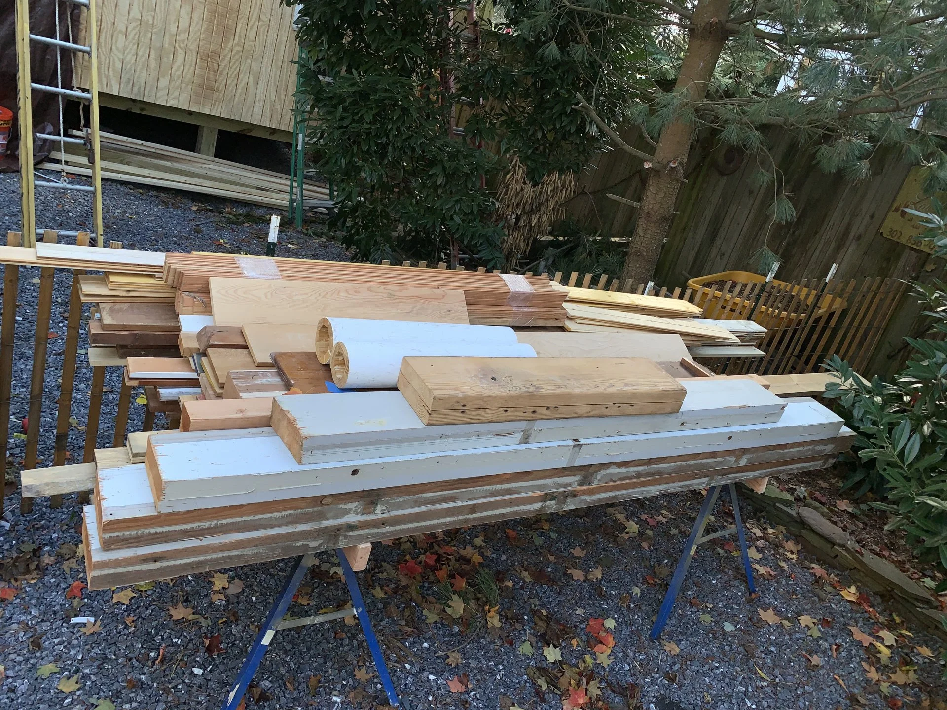

Unloading The ALL Stain-Grade Exotic and Antique Old Growth Trim Package Today for the Basement Parts Dept. Soon to be NEXT major expansion ....

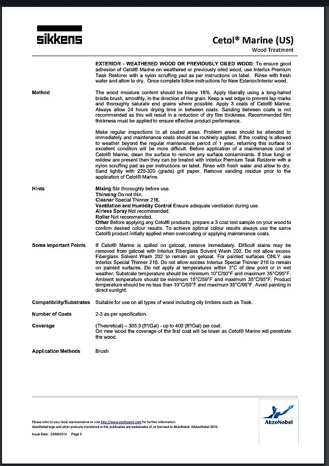

before all that takes place this is the

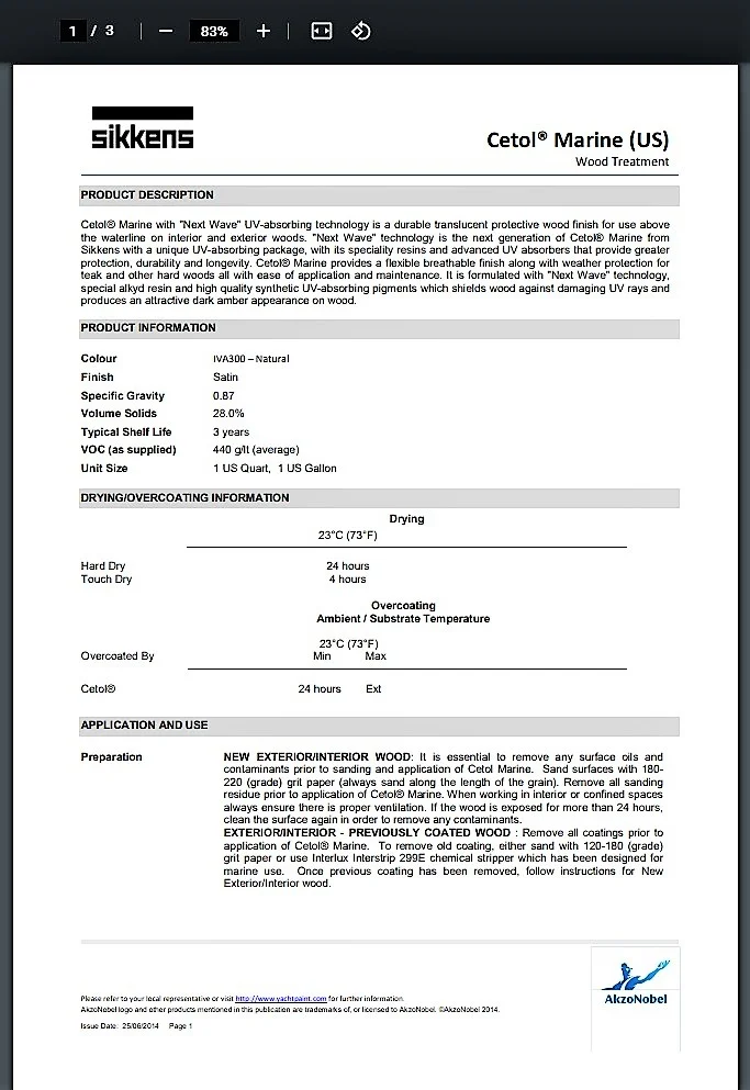

" TEq Toyota genuine parts " version of Exterior Stain / Wood Preservative :cool:
the ENTIRE T-111 structure and ALL 6 sides of ALL trim work WILL get 2 kotes of below wonder product ...
simply put : SHOW ME Another Better same in kind product , im all eyes and ears 🤔
- no sanding between kotes
- can be tinted and comes in a few stock colors like natural Teak
- has the MOST Anti UV inhibiters i can find in any like product ...........
- Quickie dry overnight type product till next if desired kote
- CAN be a one kote product
- I WILL apply 2 kotes because i like over-engineered style end products
- i have used this for over 25+ years with ONLY positive results per the directions on the can followed of course
- what say Uncle mark ? :cool:
