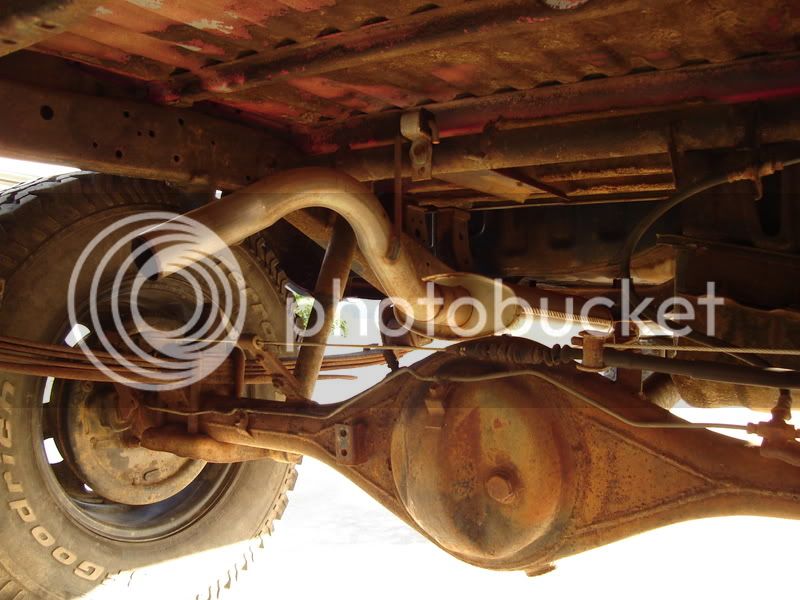

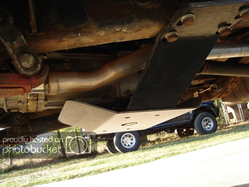

*Pics in a minute..Digital, you're gonna wish you hadn't asked, here's 11 shots just for you to enjoy. (*Well, and for future searches.) All of this stuff is C.A.R.B. certified/tagged or Laser Etched/Engraved and runs cleaner than it did originally, of course the better power doesn't hurt it at all. ;)
2009 Thorley 505 Ceramics, 2009 Dynomax SuperCat into a FLowmaster Single in-out, I forget which model though. 2.25" stainless used throughout, oxygen sensors placed at factory distances and muffler back (tailpipe) sectioned for custom bends not possible in a single piece. *I cleaned the bracket off of the EGR so I could gain some access back to the #5 plug and just make it all look a lot better.
