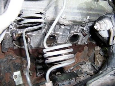

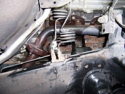

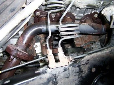

Let me start by saying that I was lucky that it was the passenger side had gone bad. After replacing o2 sensors on both sides, I think that this story would have been a little different if I had to work in the driver side. I will try to attach a few pictures that I took along the way.

Saturday I went out to the garage early in the morning, removed the right front tire and splash guard. I soaked the bolts down with PB Blaster and let it sit. My truck came from Texas and is very clean without any rust. By the way it is a 2000 with 2" OME, diff drop and 295's.

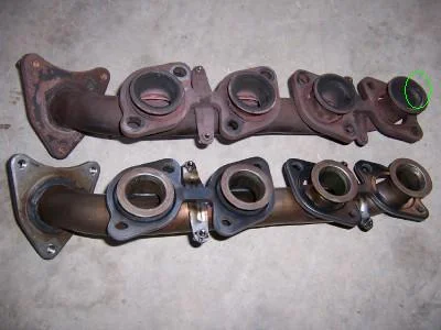

At around noon I went back outside and started removing the manifold. I have a decent collection of hand and air tools but only need basic wrenches to take it apart. 30 minutes later I had the bad manifold in my hand and was looking for the source of the leak. As expected. the flange around the front cylinder had cracked about a third of the way around the pipe.

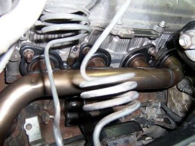

Fedex finally showed up at 6pm. The parts had actually come from a dealer in Round Rock, Texas. What I got was brand new Toyota parts in the box. I paid $207 for the manifold and $15 for the gasket. When I opened up the packages I was surprised to see that it did not come with the studs for the collector. No problem, I'll just jamb nut the old ones and reuse them...or so I thought. The studs finally came out but the threads were destroyed. Ran down to the local hardware store and got some stainless bolts and threaded them into the new manifold and was back in business.
The installation also took about 30 minutes after I had sourced the hardware that I needed. Buttoned the splash guard back in and reinstalled the tire, fired it up and was quite pleased to have a brand new sounding truck!

Can you take a picture of the crack or is to hard to see?

Yeah, the bolts I used needed connected the manifold to the exhaust pipe. The crack is a very thin hairline crack around the flange on the front cylinder. Consider yourself lucky if it is the passenger side.

The JB Weld is a good thought, but you cannot get to the cracks until you remove the manifold. There is a thick flange that slides in place and bolts the manifold to the engine block. From what I've seem/heard, the cracks are almost always in the same spot. Mine were both cracked just like the picture.

This kind of crack is easy to weld repair and stress relieve and save the cost of the new part. I would also consider annealing the new manifold flanges prior to installation.
