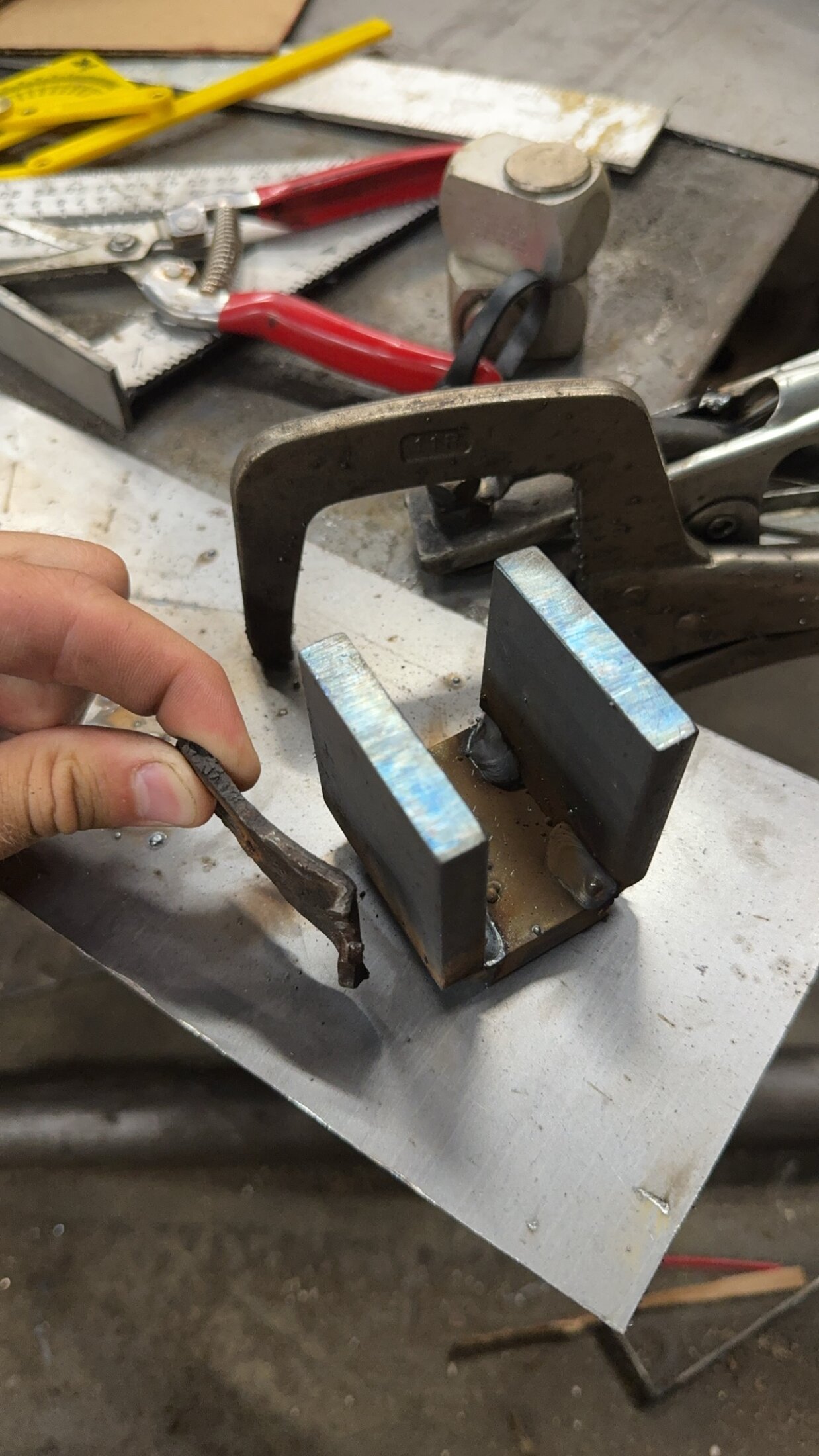

Me and my buddy fab’d up some new links for the front and welded them last night. Re connected the front sway bar and now it's much better of course. LCphil rear links are ordered so I can mount up my white line upgraded rear sway bar. Orda make an even bigger difference in body roll. After my big trip it’s time to do castor corrections.
YES I went overkill with the mounts but….. it’s MINE!!
Sucker won’t break
Pics of the factory mount vs what we made. Cheers.
