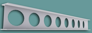

Yeah, good point. I thought I saw a rigid member connecting all the towers, just can't recall where that was. I might have to fabricate something similar to the Prinsu rack design, PrInSu Design Studio - 80 series roof rack
Perhaps incorporate the 80/20 bars into some type of Alum side rails.
The PrInSu design uses some pretty thick looking material. It looks cool to. You would get better force distribution with more cross sections connecting the rail to the rack.
