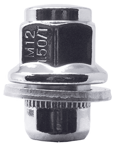

I don't want to add a bolt on spacer and create potentially issues but I want to a spacer between the hub and wheel to change offset by 10mm (+50MM is recommended for 33" wheel size). With a spacer, definitely I will not have enough thread left to have the required 8 rotations.
Did anyone buy and can recommend extra thread (ET) lug nuts that will work on 16+ LC. In the attached example the lug nut has an extra neck to engage thread earlier which is the type I am looking for. I am open to both black or chrome finish lug nuts. Thx

What wheel are you going to use these on? What is the required mating surface?
you will need to change the studs to do that.. not the lugs. you would need M14x2" studs.
OEM is M14 x 1.5" ... i just got some match the trailer to the vehicle. so 10mm is just under 1.2 which is about 1/2 ".
Now you can get stubs that are m14x1.5" and seat differently. i.e. stick out further and that's another option for what you want to do.
Thanks! Looks like 2" is way to go. Thanks for all the help!
