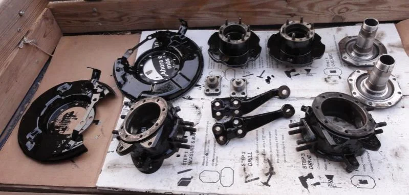

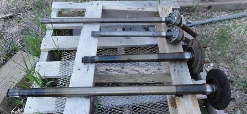

Ok, guess I've got to do one also. Don't expect Rui-like speed on this though! First order of business is getting rid of the scary single circuit 4-wheel drum brakes. I got a great deal on some axles from a 74 FJ55 and took the knuckles off of an 83 mini truck. I've gotten the axles torn down and mostly cleaned up - paint soon. And have gathered most of the parts.
Disassembled axles and shafts - even got the kids to reach down into the oily diff to retrieve the axle clip. Of course I could just rotate the axle, but it was more fun this way :grinpimp:

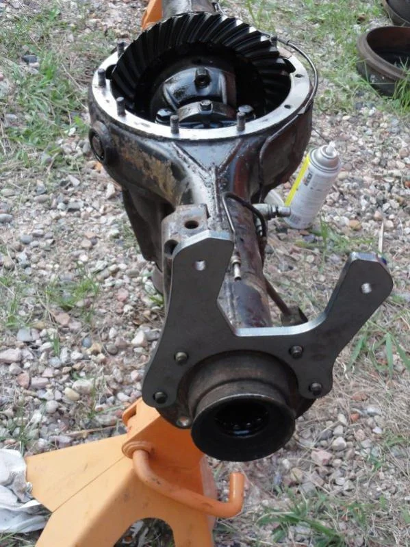

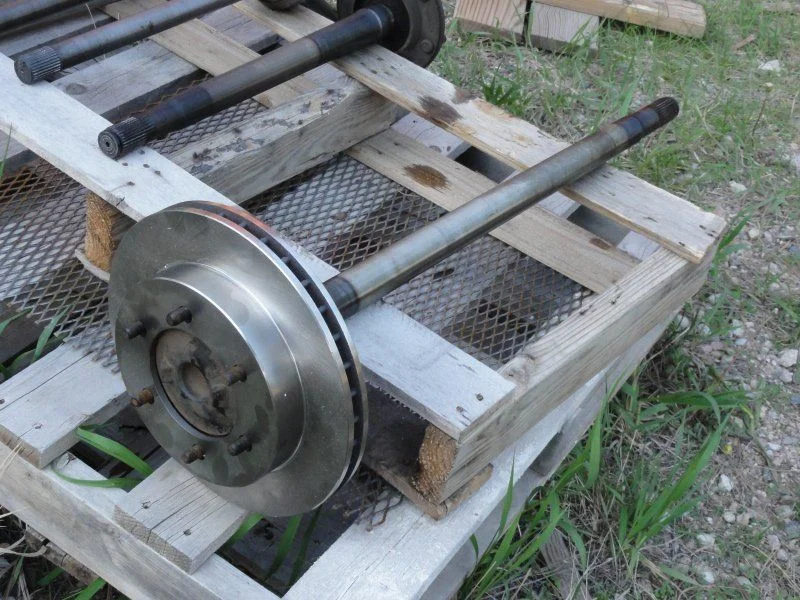

A quick test fit of some bits from Poser's rear disk conversion. Rotor is from an early 90s GMC 1500 with the center opened up a bit.

So for the front axle - I'm putting mini-truck knuckles on it with FJ60 vented rotors and 4Runner calipers. The line on the short side is kinked a little, so I'll have to replace that but it looks good otherwise.
Back axle will get the Poser kit, which takes Monte Carlo calipers. On-axle brake lines look good there.

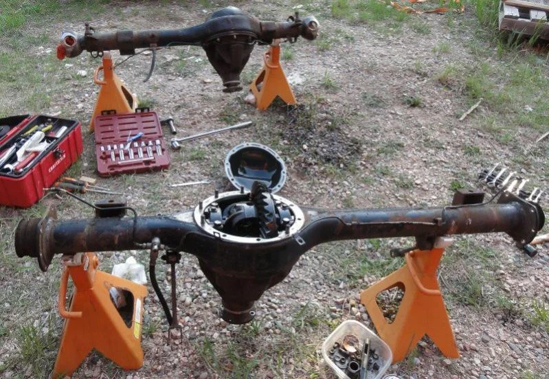

Meh - it's supposed to be a driveway, so I'll just dump enough oil and degreaser on it to kill everything. You can see a good start on that in the first pic ... one end of the axle fell off the jackstand before I had drained the diff. On the rear axle, I drained the diff first - I can occasionally learn from my mistakes! :bounce:

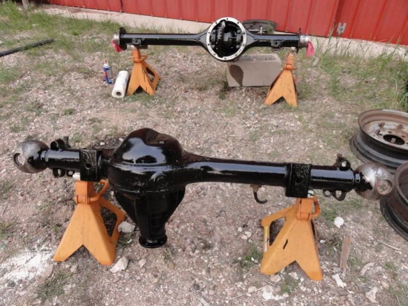

Prep & paint all day today. That Chassis Saver is some nasty stuff - forgot to put on gloves, and I have a feeling I'll be wearing this until I shed my skin.

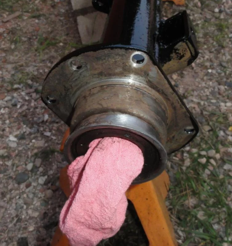

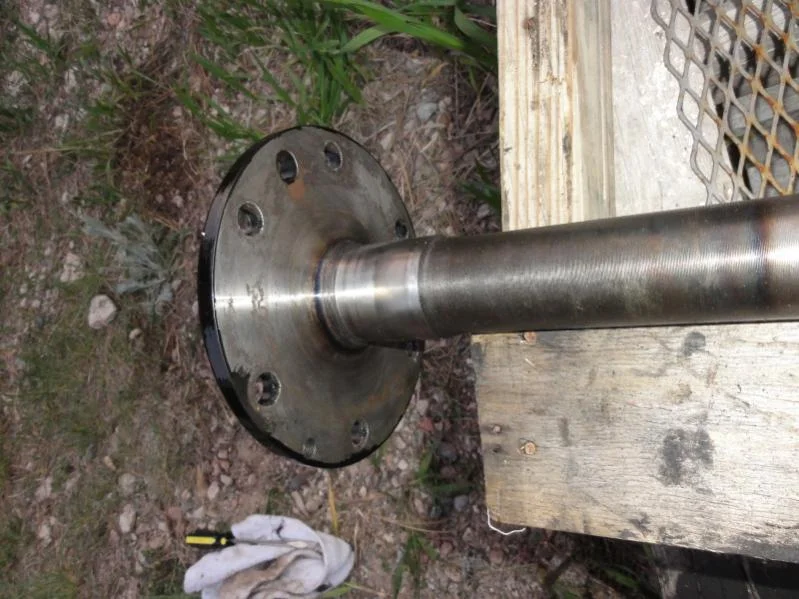

What do you think? Should I paint this side of the flange on the axle tube, and the stuff outside it?
How about the inside of the flange on the rear axles? Any reason not to?

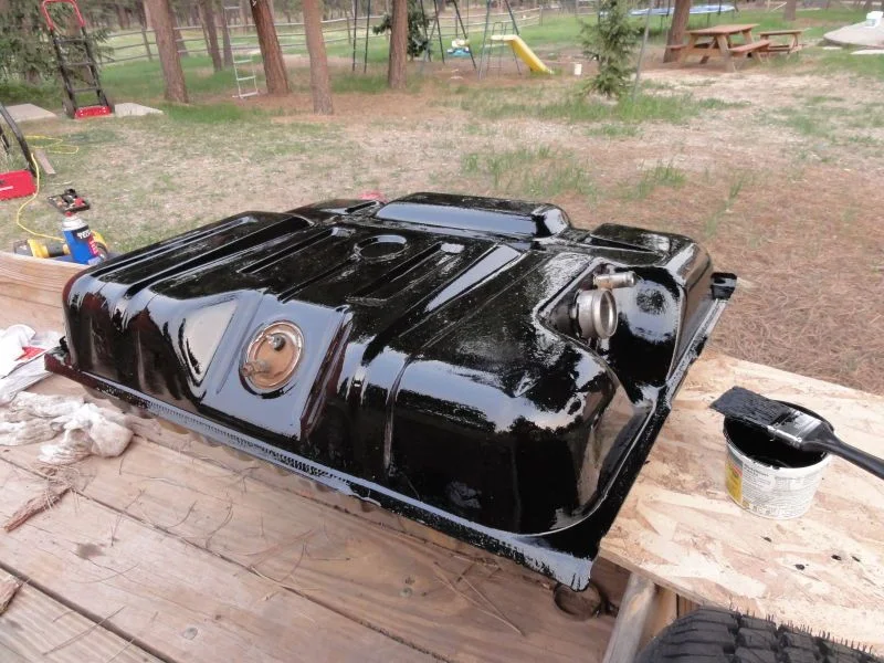

Another project, but since I was making a mess anyway I cleaned it up and painted it.
This is a 19 gallon subtank from an early 70s Ford pickup. I think it will fit right up between the frame rails where the spare tire sits on the 80, and the inlet is on the correct side.
Dumb question time ... when I took the diff cover off the rear axle, a few of the studs came out rather then the nut coming off. Any suggestions on how to get the nut off the stud & reinstall? Or should I just treat it like a bolt?
Second option worked for me, put some threadlock on it and once it bottoms out you can still tighten the nut...or just use a vice put a nut on the other side and crank on the one that is tight...
