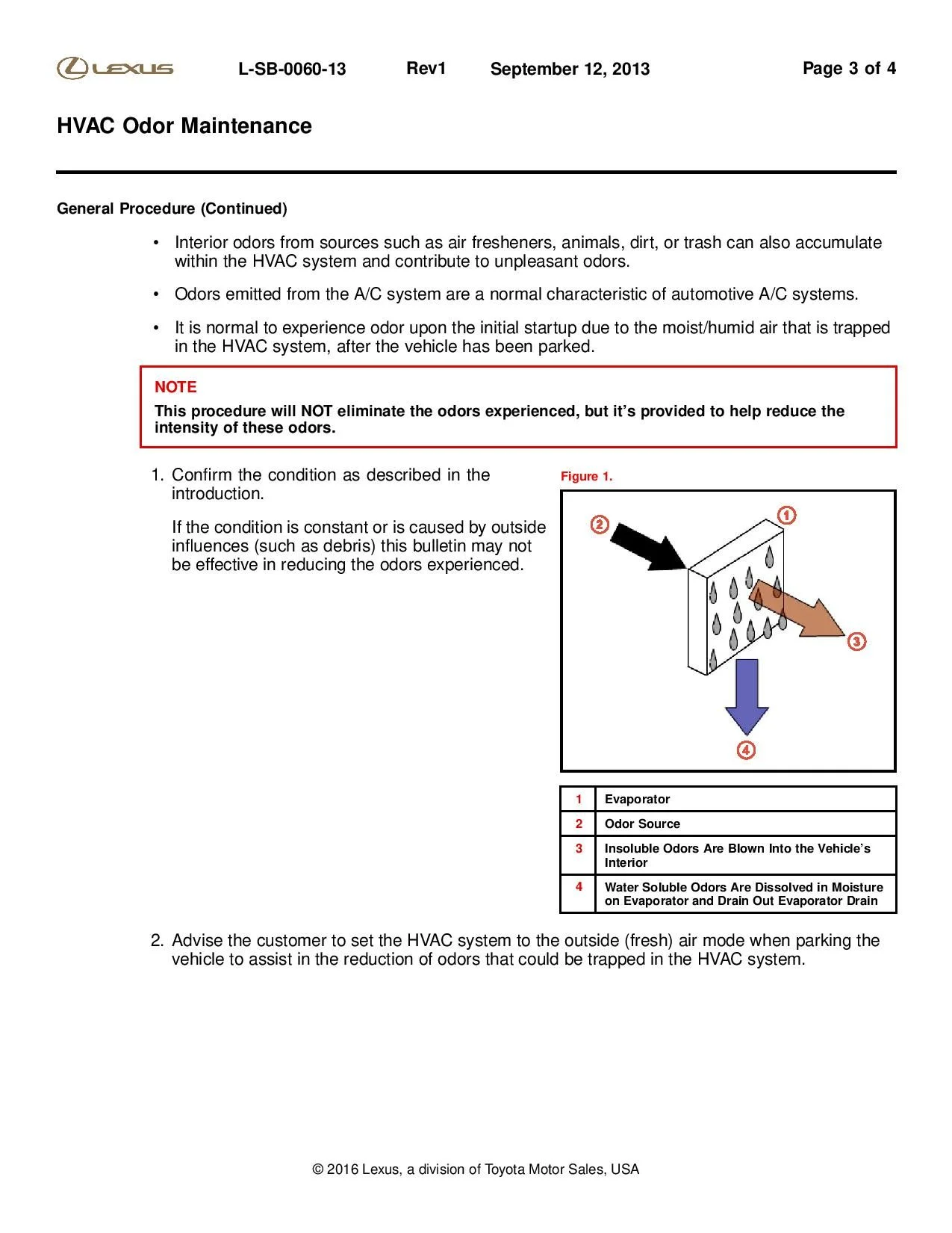

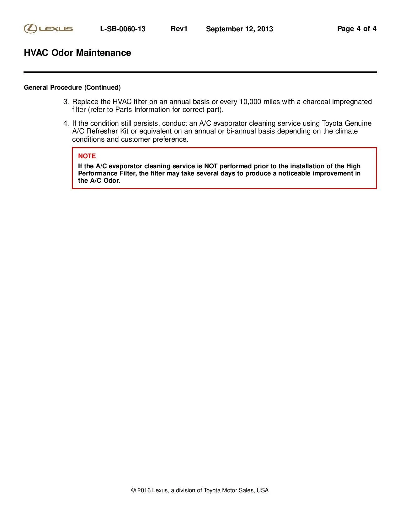

It could've possibly been for a smokers vehicle, but the specific "AC" callout made me thing of something else. Several late model Toyotas I've had (owned, rented, family, etc) can often develop a HVAC system smell that reminds me and the wife of cat urine. Internet seems to tell it's not a completely uncommon thing that happens with certain designs on the AC system in these vehicles.
I forget the details exactly, but it was effectively something like the AC condenser wouldn't dry/drain (unless you turned off the AC a few miles from parking it at home) and the result was funk smelling up the AC vents next time you ran the car. Fix was described as temporary, as it was a condition fix not a cause fix, but lysol in the vents and a cleaner on the condenser (or something) would kill mold/mildew for a while.
Anyways, not that it's a better alternative to smoke, but wanted to share it as a potential issue if it's not clear whether it's a smoke issue or AC issue since the cleaning service noted "AC Treatment" specifically.
Could probably find out a lot more with a google search of "Toyota cat piss AC smell", sorry I won't do it for you, I don't wanna relive that again :vomit:

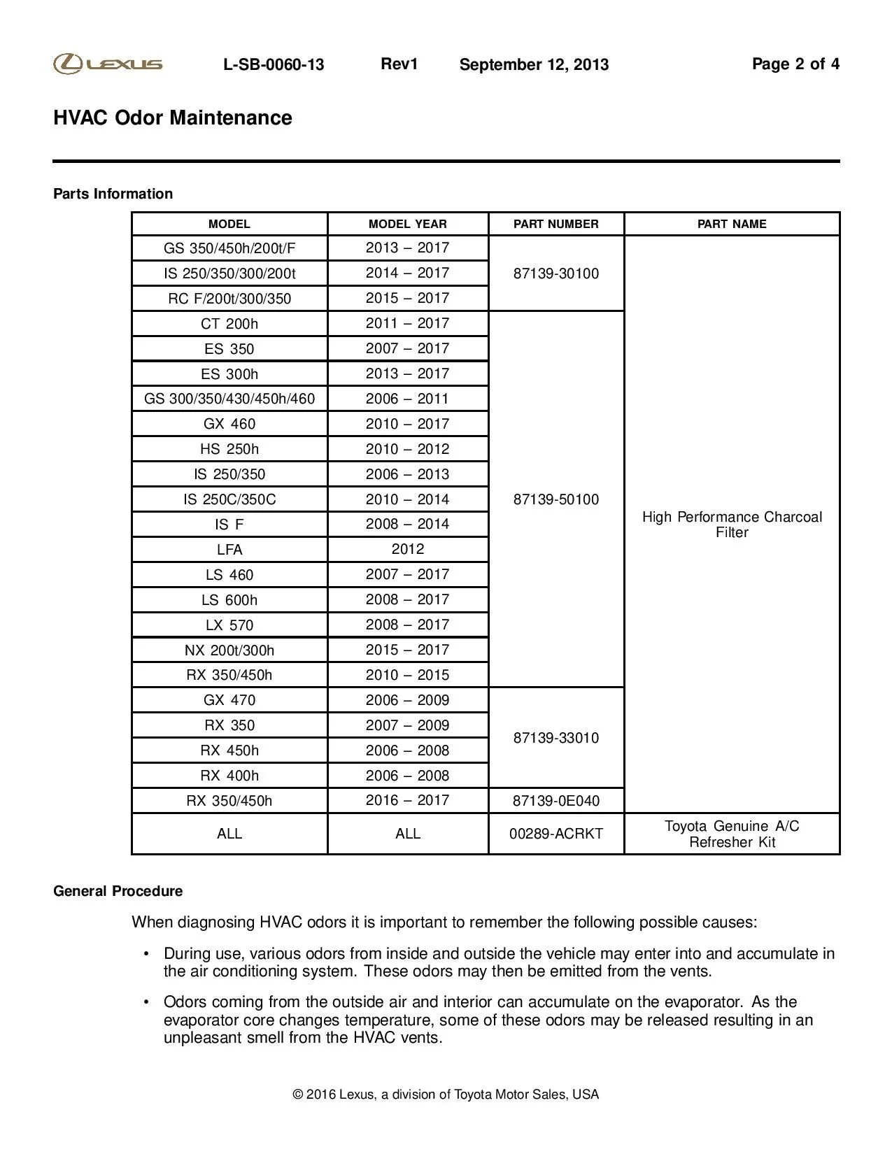

There is probably a newer version of this TSB to include latter years
