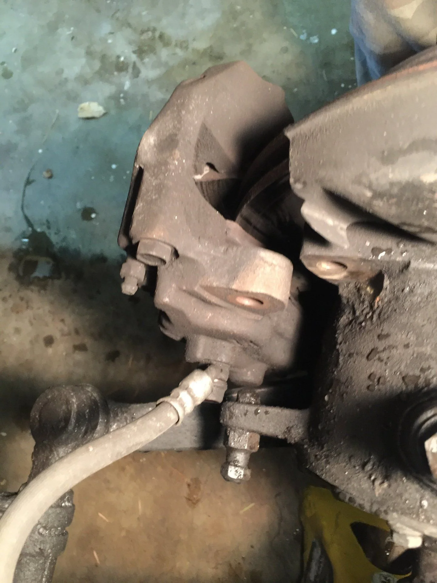

So I just got home and am inspecting and the clunks happen when I depress the brake pedal about 1/2 of the way and depress it normally. If I depress the brake very slowly the clunking is a lot less noticeable. Any thoughts about the clunk noise would be appreciated.
I’m an idiot.... a brake caliper bolt came off

I drove home doing about 10 mph and used the ebrake. Still seemed very sketchy.
It may not have been your fault entirely. The FSM says to replace them when you pull them. There's a lot of torque on them, assuming your torque them properly. Considering the fact that it's a life safety component, and it's pretty cheap, it's hard to make a case to reuse them.
Thats good to know. I am fairly certain i torqued them down correctly but have always reused the bolts....
I did buy new ones and will put this on my check list for long haul inpections.
