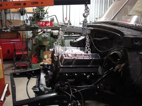

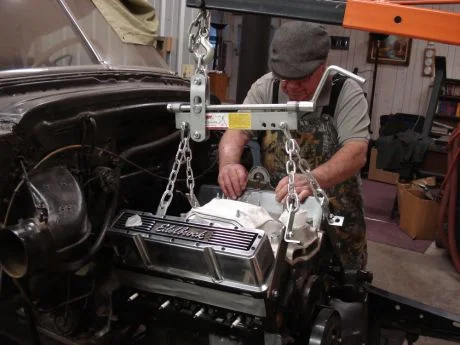

Just thought I'd update this and say I got it and it is really, really helpful. Sure beats trying to keep the tail shaft up with a floor jack while you are setting the angle. Thanks again. Sorry the pic isn't of it going in a cruiser. I need to get the '49 Olds done so I can get the 45 LPB in and start working on it.
