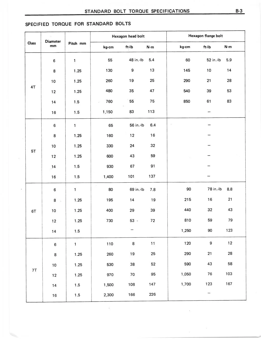

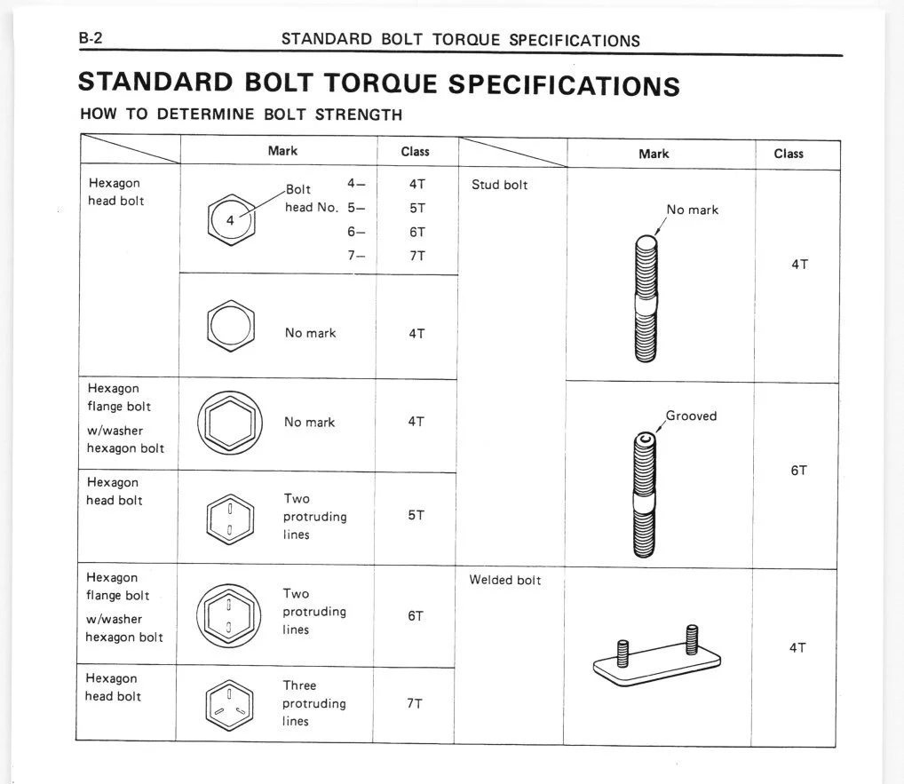

Torque specification probably aren’t crucial.
However this chart might help - I found this in another thread for F series motor mounts.
Bellmetric.com
Will have what you need
