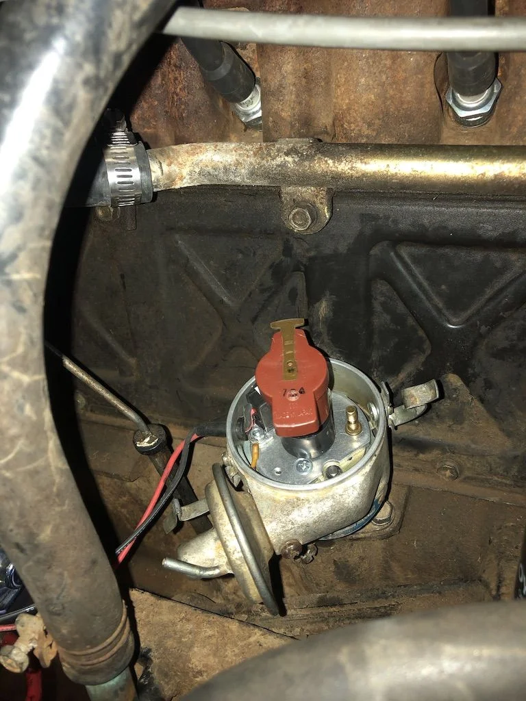

Fellas...here is the update. The range of motion for the rotor went from about 3 degrees to about 20 degrees after cleaning it up and removing the 2 small lock washers that were randomly sitting in the bottom of the dizzy. Look at the picture...with it at 7btdc, the rotor is pointing at about the #2 spark plug which is not right. I pulled the dizzy and reset it to be pointing at the #4 spark plug (2nd picture). Engine starts and idles pretty nice (good oil pressure)...any added throttle makes it sputter/stammer. I have my old carb (that I rebuilt...but replaced with the City Racer carb because I couldn't get the engine to start (a long while back). I'm going to put that original carb back on to see if that makes a difference and will update.
*Note...for others with the same issues...the reason for the backfire was because I had the rotor 180 out from where it needed to be.

However, the distributor rotor is notched. It only goes on one way, so if the cap was assembled correctly regarding the housing, then, I'm confused how you report the 180 degrees off problem.

Ok...I'll check the spark plug gaps and pull the valve cover and check the adjustment. It wasn't a huge backfire, more of a pop, but caught me off guard. I think I was not on TDC...I was 180 out from that? Either way, when I changed it, it started and ran, etc.
Update...got the original carb on there and adjusted the timing and got the motor to start. Runs well at idle and stutters again anytime any throttle is added. 2 carbs and similar performance. Timing seems good and the rotor points to the #4 plug. Waiting on parts for EGR removal and will install that and adjust the valves after the install and see how it goes.

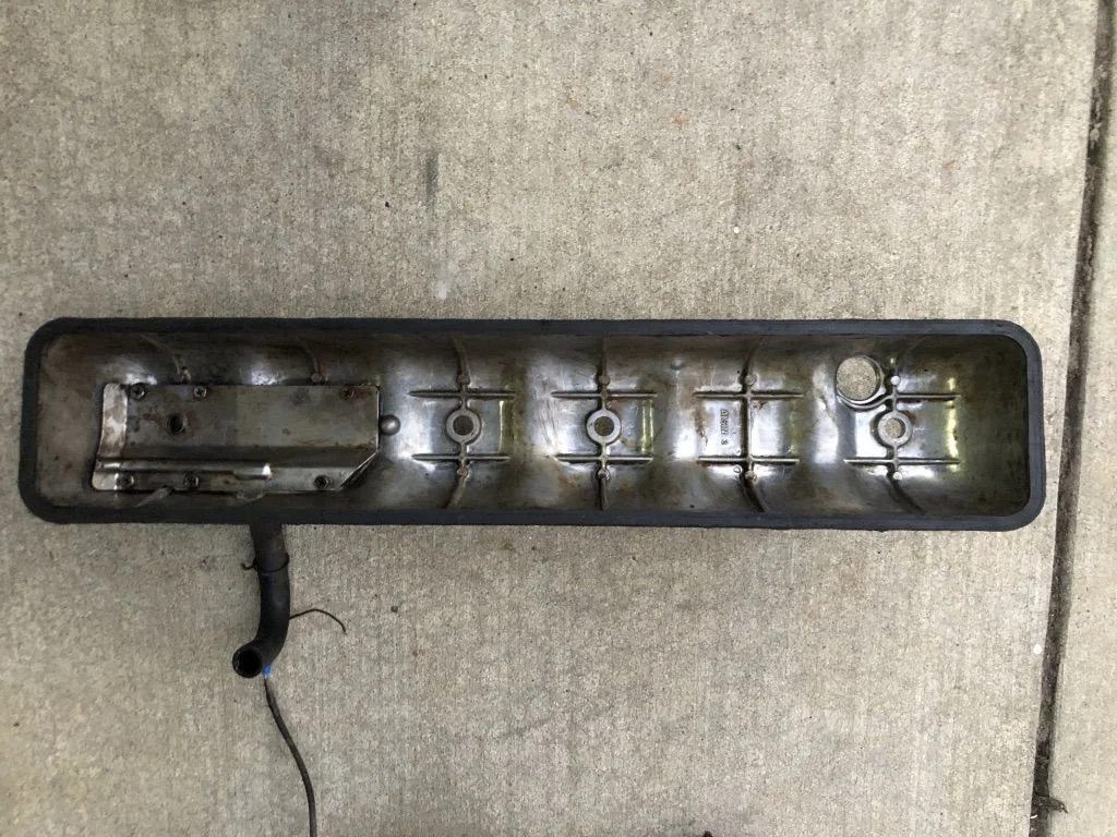

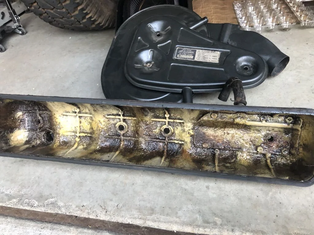

Update...took the valve cover off to try to do the valve adjustment and the inside of the valve cover didn't look good. Tried to start it for a couple tries and it didn't start. Had the same froth in the valve area. Attempted to take the radiator cap off to see if there was oil in the water and the pressure blew coolant out (the engine was completely cold...didn't get it started. I never did get the coolant flush done before this. I assume that's a head gasket? Assume also the head gasket could be the reason for my problems? Not what I wanted to find out.

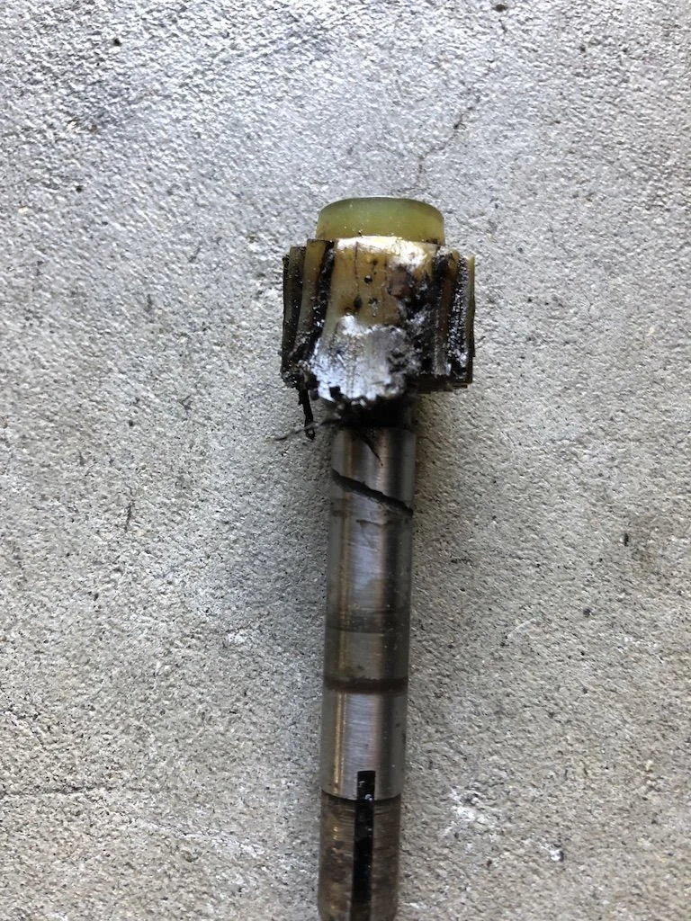

I spent a ton of time getting the electrical to work (I haven't attempted the reverse lights yet...but think that should be a quick fix) and have everything working like it's supposed to at this point. I even had to replace the speedo cable (see pic) and run it straight to the speedo instead of to the emission box thing (the technical term).

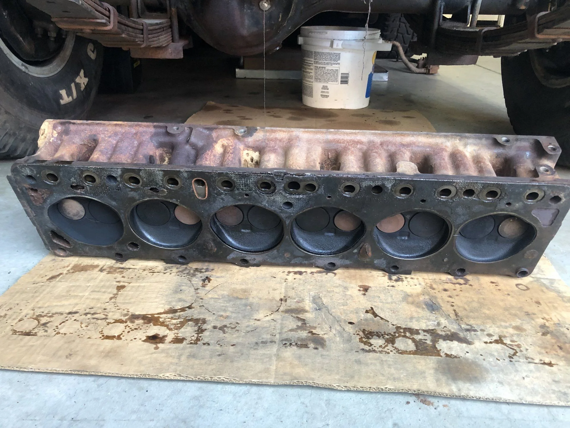

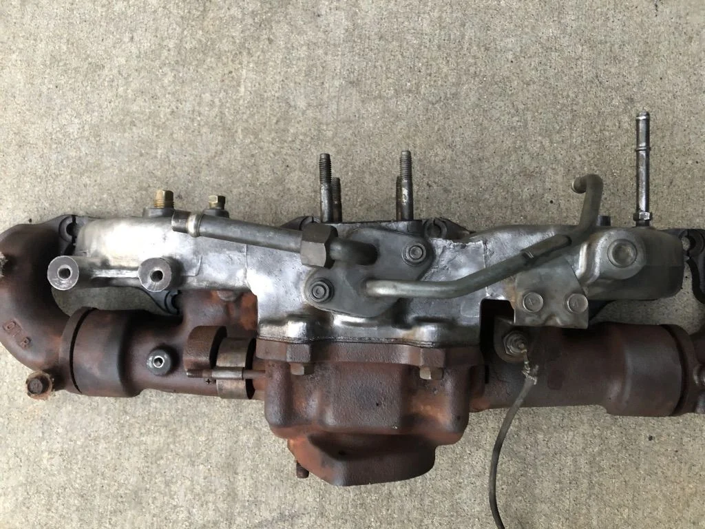

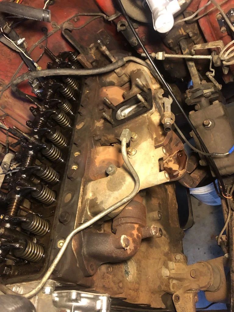

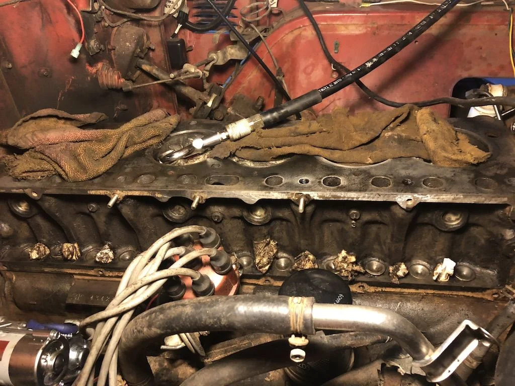

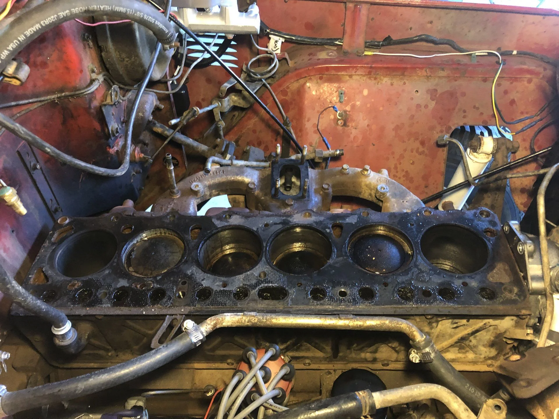

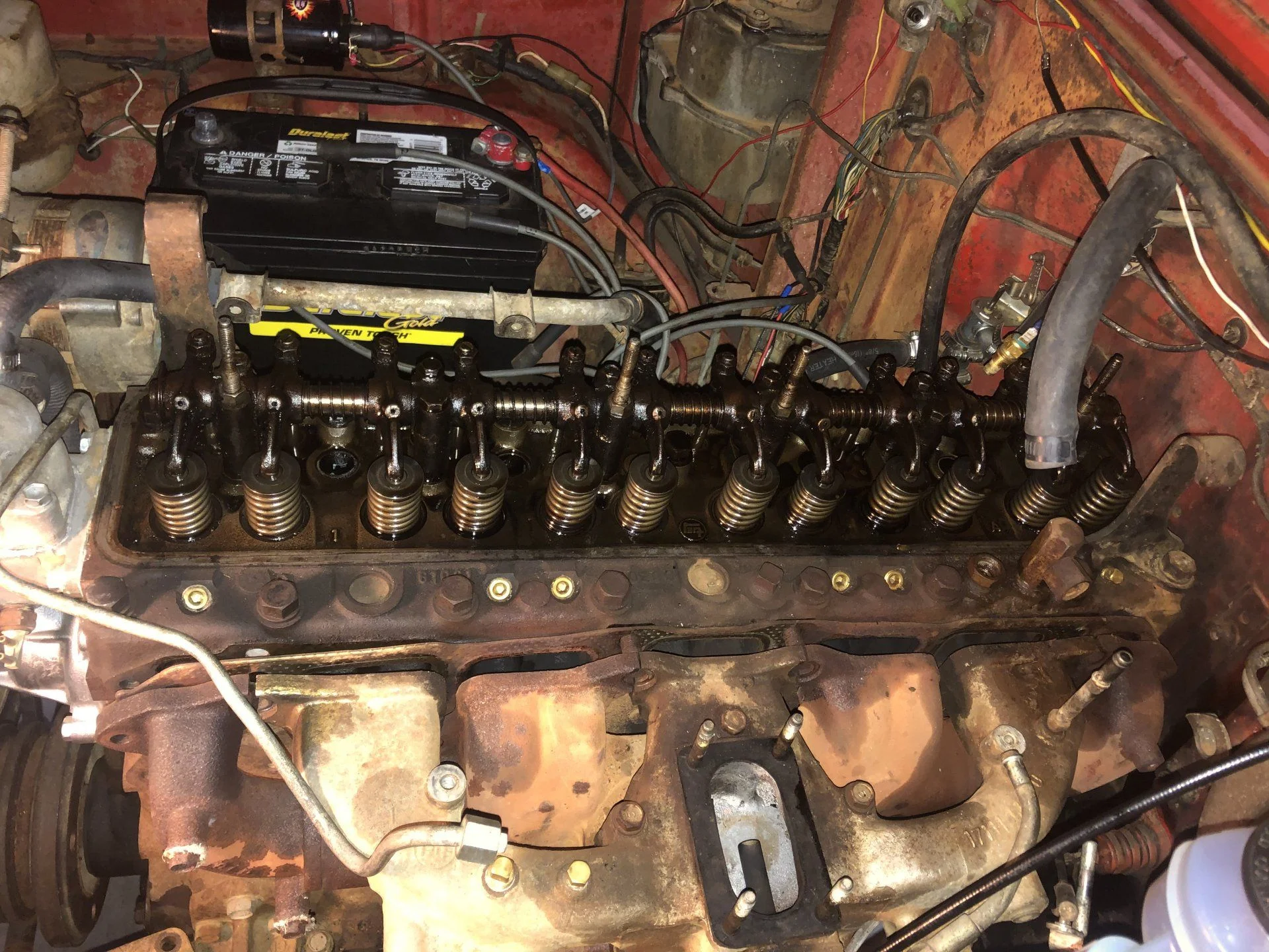

Pulled the head today. Pictures attached. The Heater Union Swivel broke due to major rust...and a couple other screws/bolts broke due to major rust. Taking the head to a machine shop tomorrow to machine the head and do the valves. Will have to fish out those broken bolts while waiting on the head. Btw...I had to get a big fricken screwdriver to pry the head off...and had to remove the alternator (forgot that part at first).

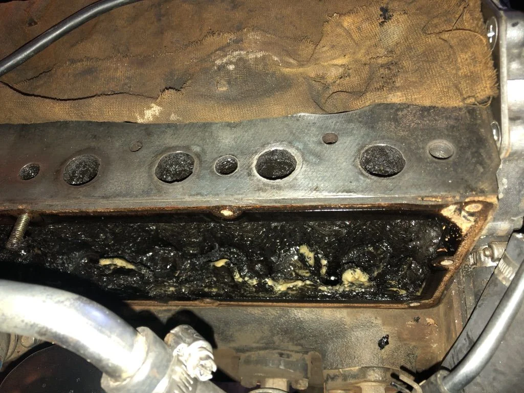

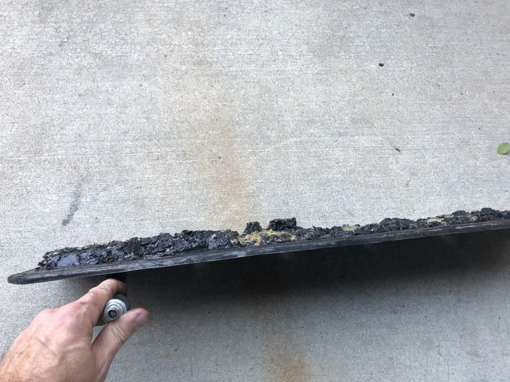

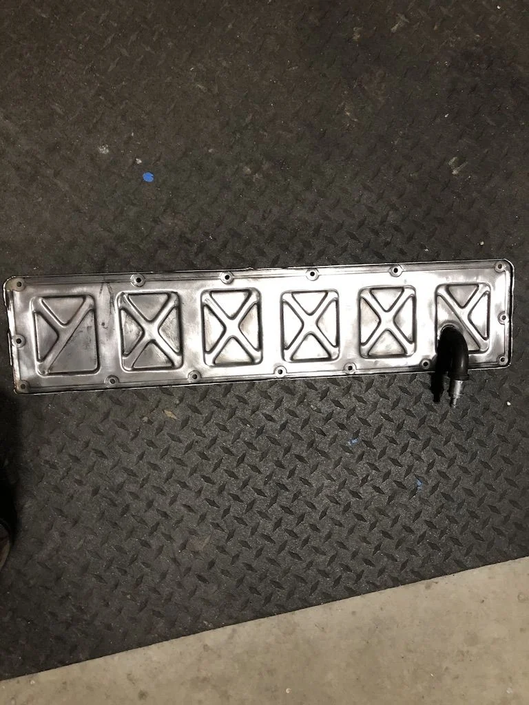

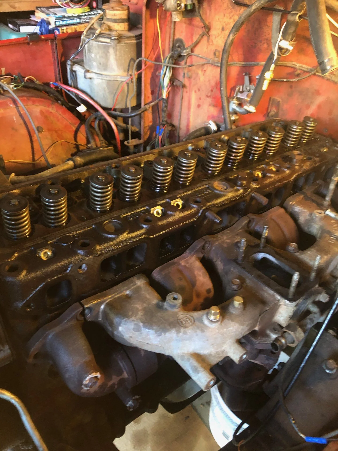

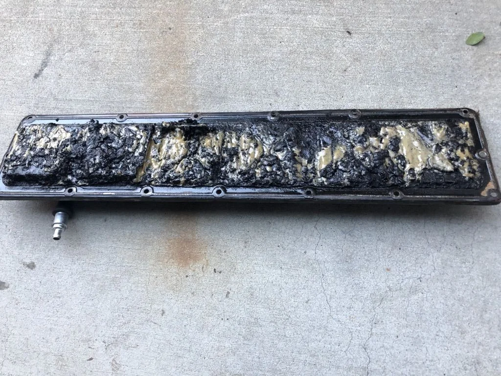

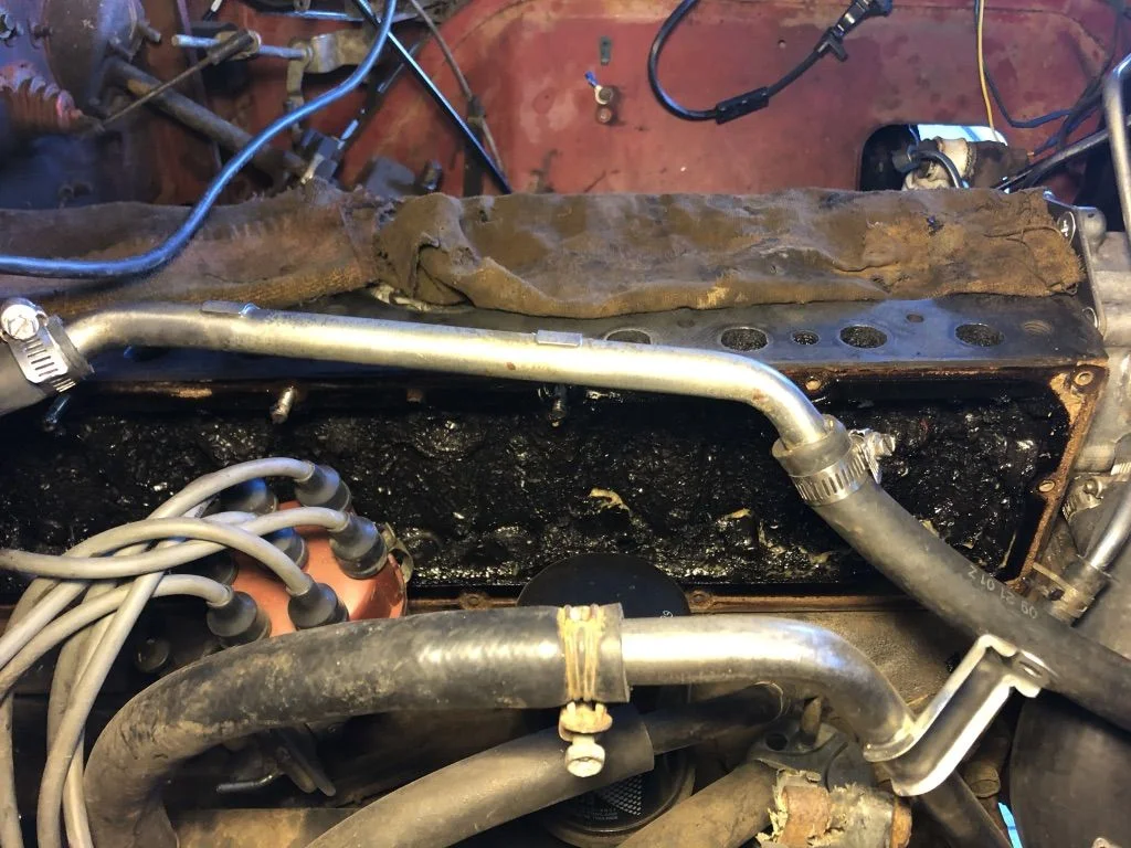

Got the head back from the machine shop. Nobody mentions how bad it sucks to scrape off the old head gasket. While waiting for that to come back, I cleaned up some parts getting it ready to reassemble. I decided to paint the block black and took the push rod cover off to clean it up. Holy crap...talk about a ton of gunk.
In for a penny, in for a pound... or two of sludge!!! The rabbit hole is getting deeper and the light at the end of the tunnel...is a 🚂🚂.

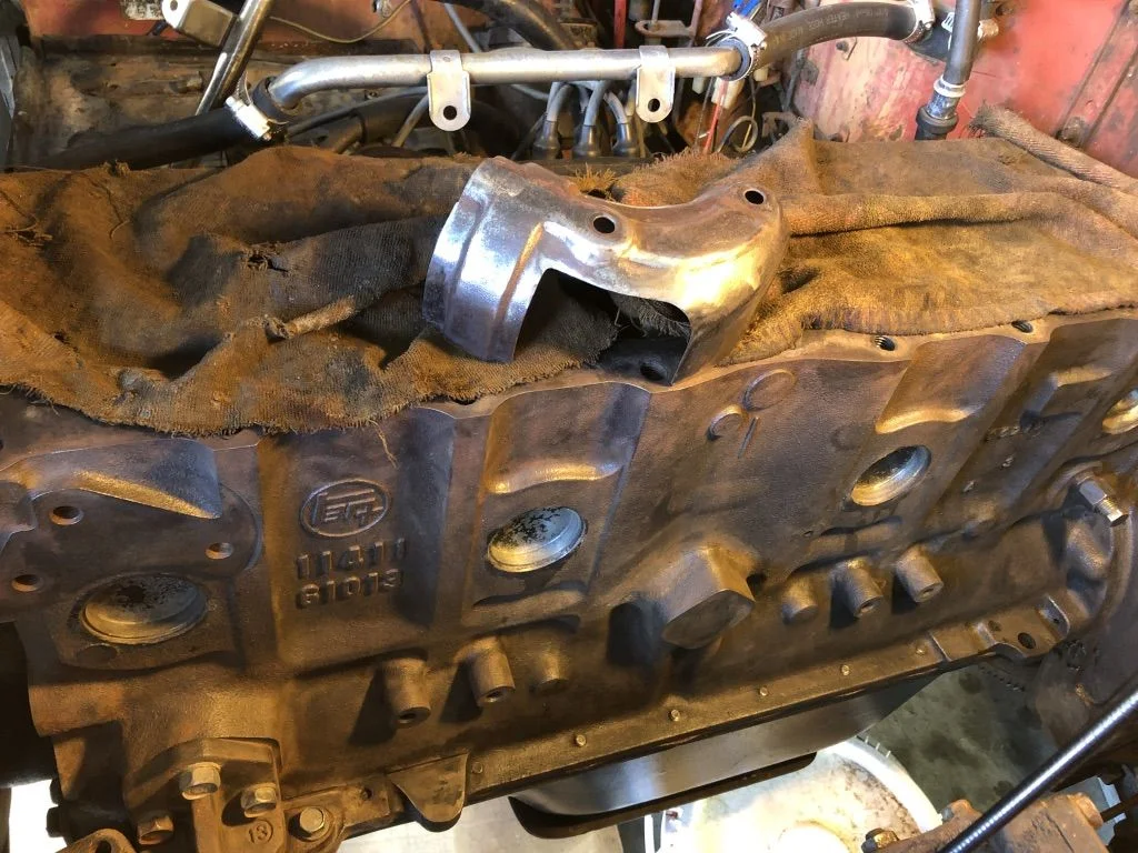

@FJ40Jim, roger that. It's on the way. I still need to weld small plate to the EGR valve plate. Question...do I cut off the pipe from the inside and outside of the plate and weld the new plate on the inside? The inside pipe goes into the intake manifold. I'm assuming I can cut that off flush and weld the plate to the inside?

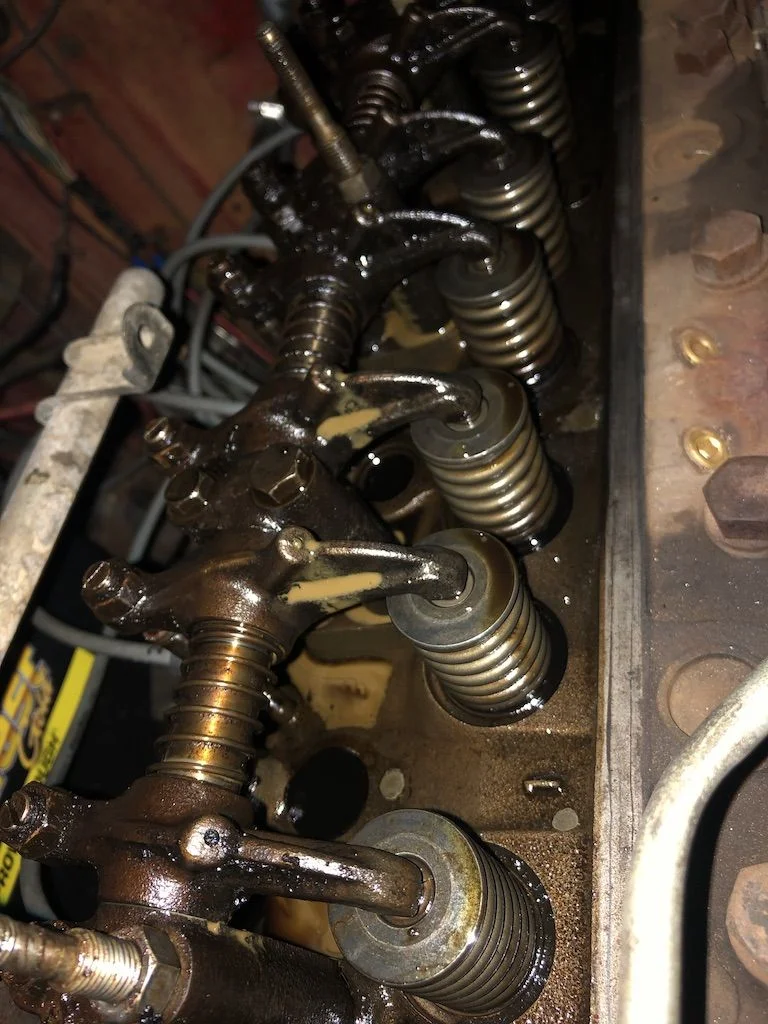

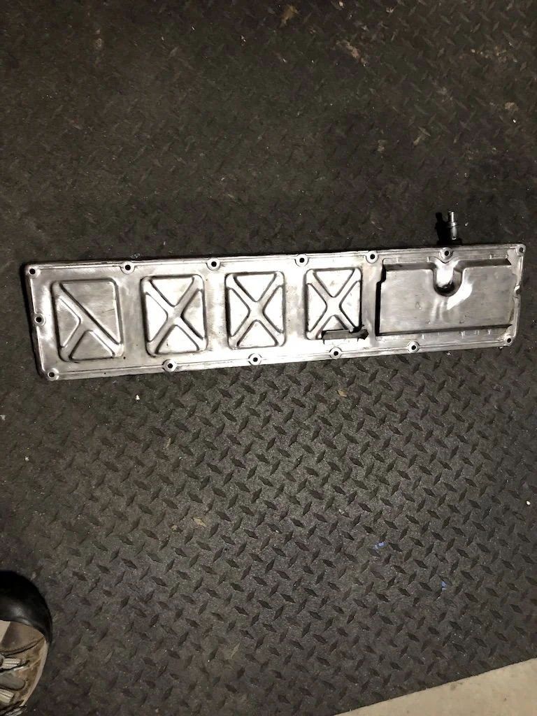

So much sludge...still need to clean the area where the pcv valve is...and the remainder of the cork from the push rod cover.
That looks gooooooooooooood!!!!!!!!!!!!!:clap::clap:
