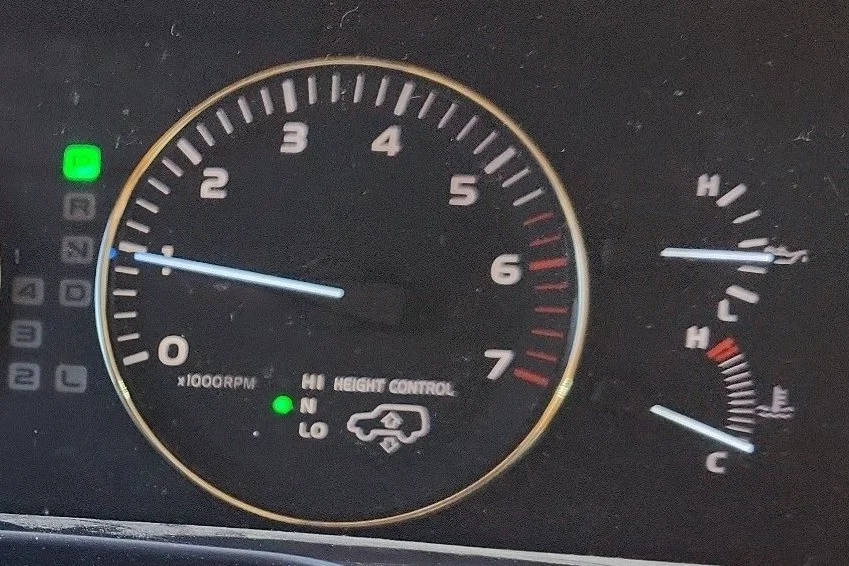

Spark plug blew out from cylinder #5. Second shop scoped the engine, didn't find any damage. Installed Heli-Coil, new spark plugs and ignition coil.
Good to hear it’s back on the road!
