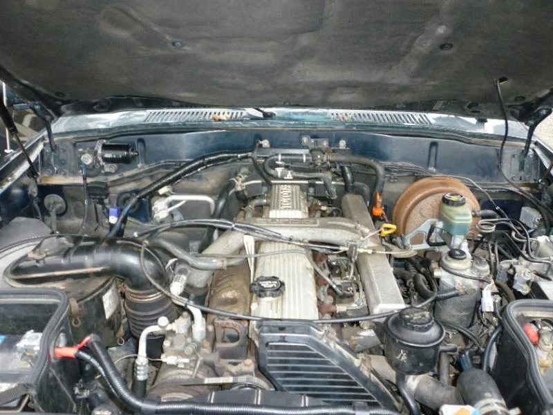

Hello everybody,
Building my fj80, it has the 1fz fe and A442F.
The transmission is fixed but I wld like to hear your advise if its feasible to change from 1fz fe to another diesel engine ? And do i need to change the Ecu or other electronic parts?
