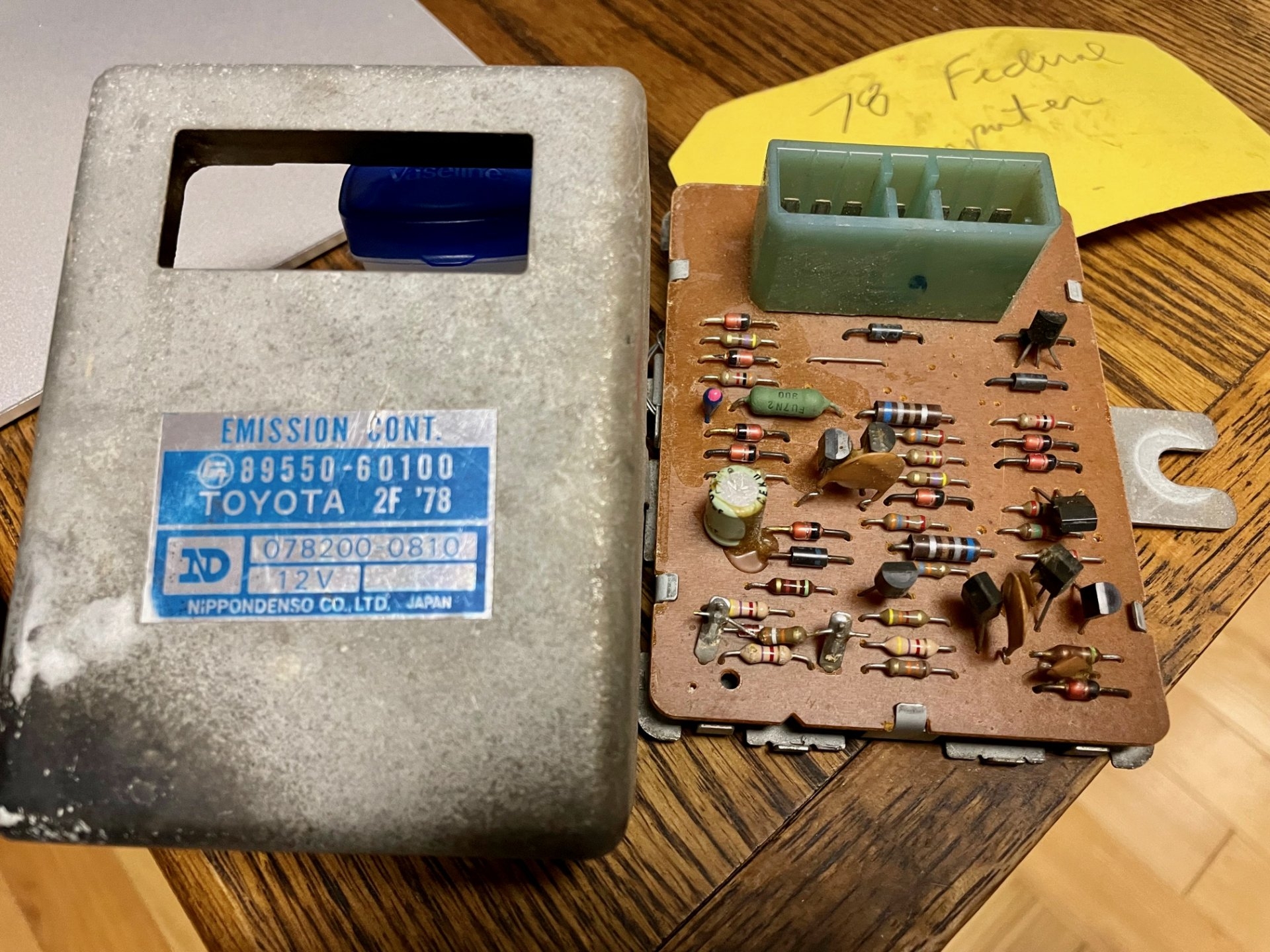

Are you collecting modules? I have a 89550-60100, which I believe is for a 78 Federal system. The guy I bought it from was replacing the 2F with a SBC, so I purchased the engine and all the smog components. If want it, PM an address and I will ship it to you.View attachment 2728318

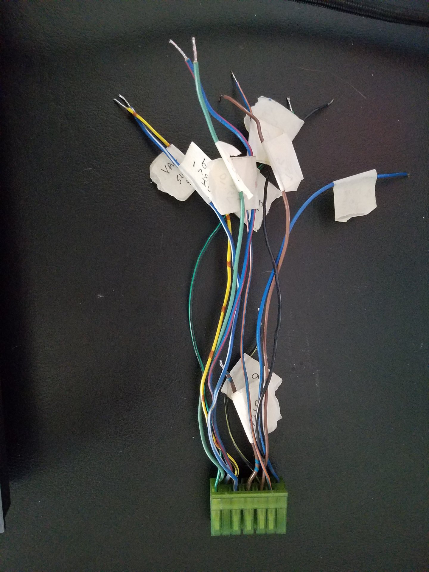

Im looking for the Green / blueish tint Connector Housing that plugs into this module ?
can anyone help out here with any information like a toyota or YAZAKI Part @ perhaps ?
thanks !
THIS EXACT Plug Connector

I think that's it ! --- the one he pictured....

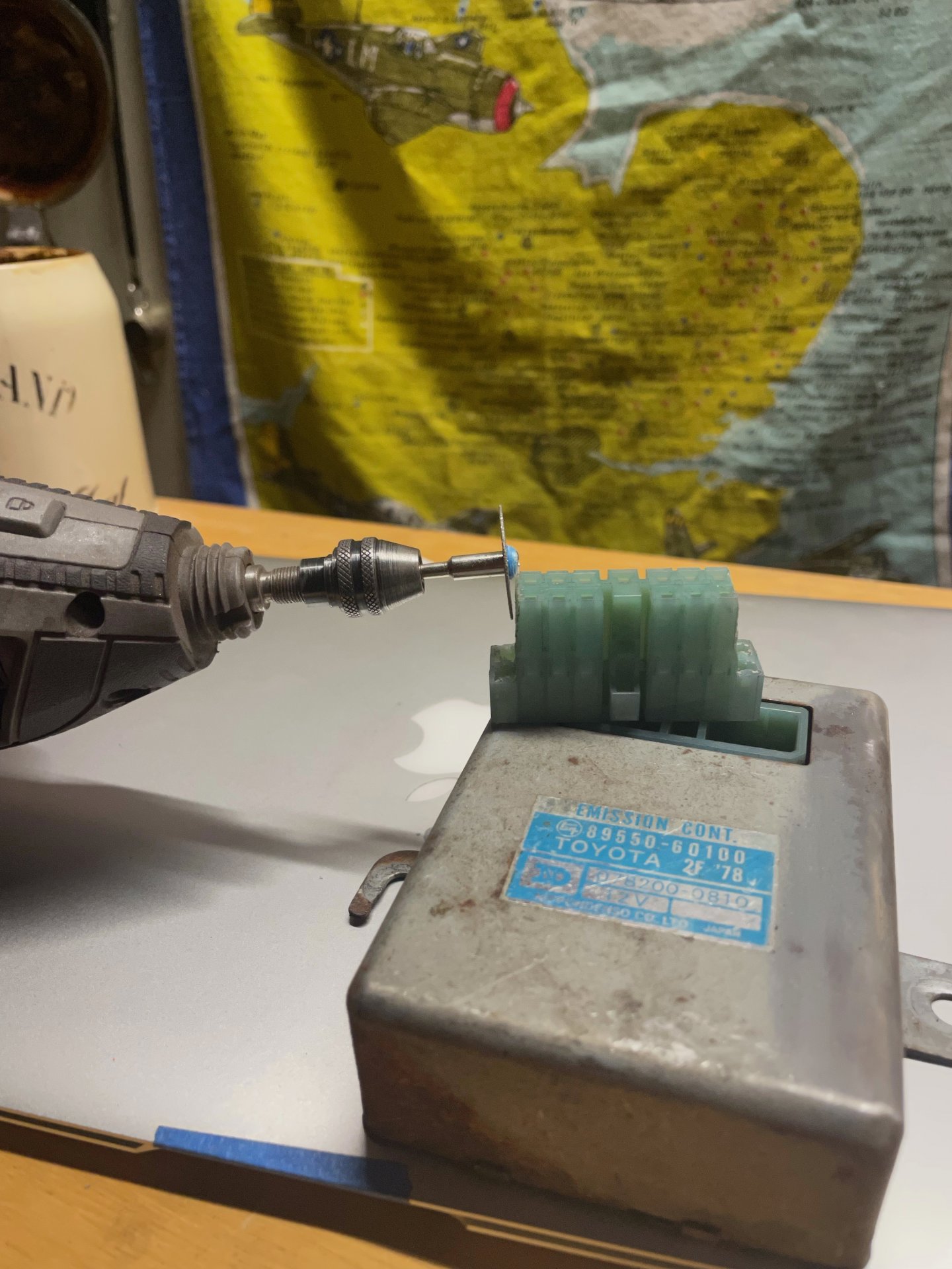

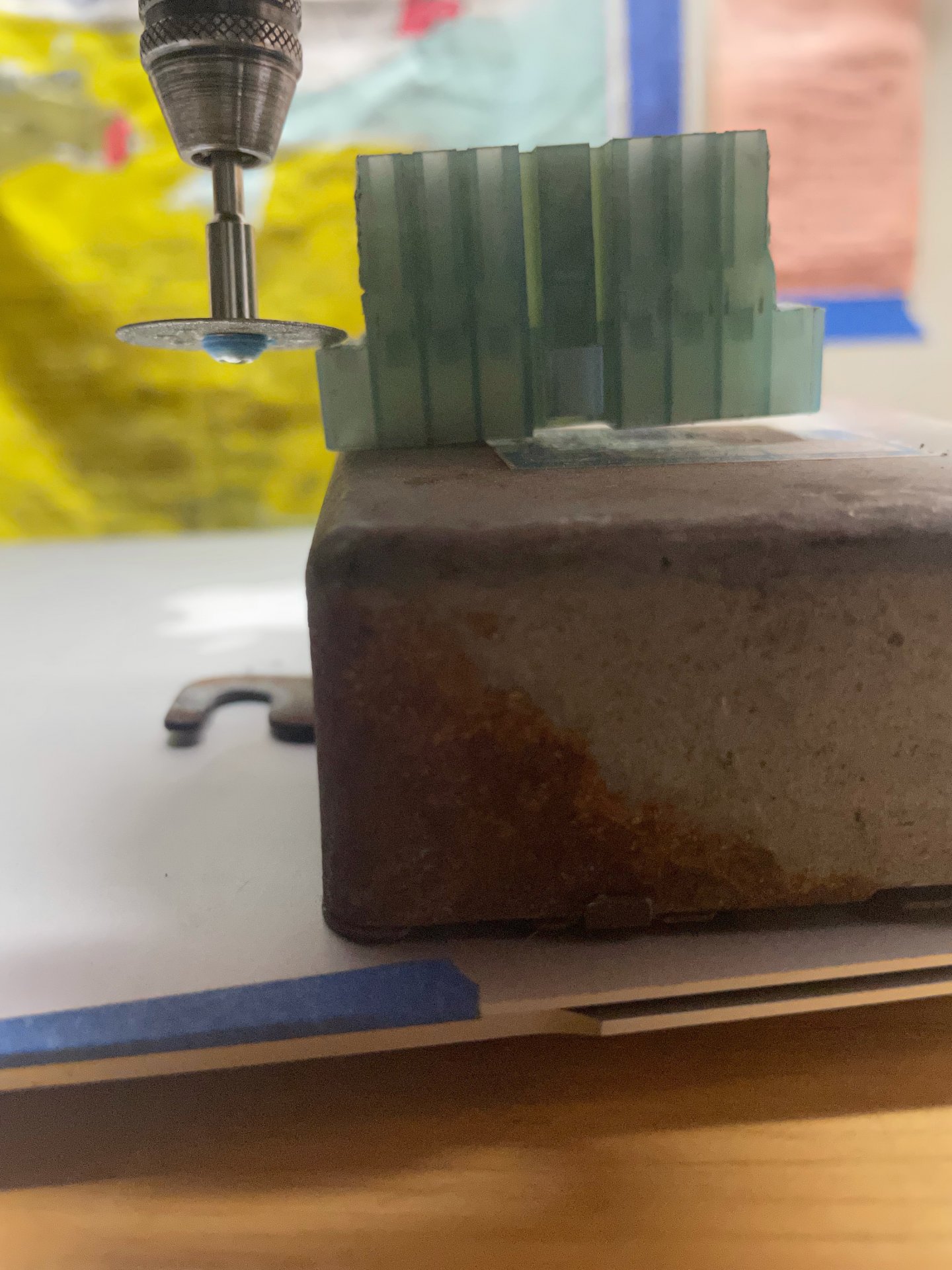

well I got crafty with a Dremmel and made a plug work literally perfectly. When you have a dremmel - you have access to literally any type of tip you can think of. Anyways i just used the regular small cutting blade and it whipped right through with ease and was nothard to control whatsoever. here are the pics of the results...I have a plug that i can work- that clips and everything. One word - McGuyver (spelling>?)
**Special thanks to @ToyotaMatt who always comes up with the parts even if we have to get crafty :) good stuff Matt - we got it done. hah**

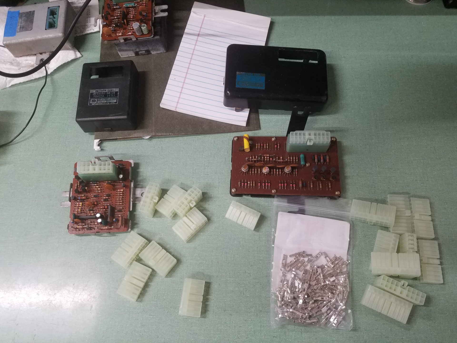

Found these, 13 and 17 pin connectors with the correct interlock and terminals for the emission computers.
I have the same issue and looking for a 13 Pin connector for this emissions control module - where did you purchase these from? Thank You for any help you can give me.
I have several on hand, PM me if you would like to purchase. Thank you.
