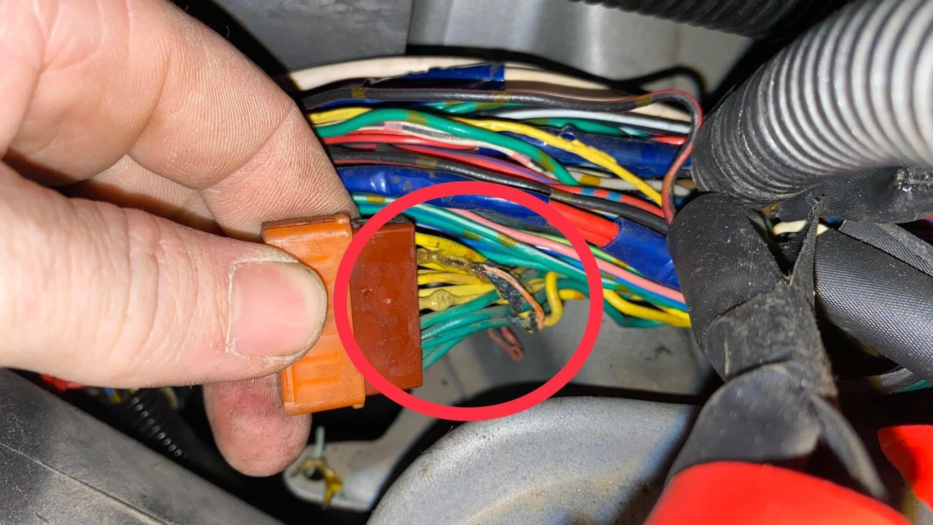

Even writing out the title of this is giving me ptsd. I bought a HJ60 about a month ago and ran into almost immediate issues. Anyways, Im in search for just the name of the terminal connector part that I need if anyone can help. It goes to the orange sensor that sits in the main loom just at the top of the steering wheel brace I guess you'd call it. I've bought 3 of the wrong terminals and dont really want to make a 4th mistake. Here's the pictures, found 4 completely BARE wires running in my loom :rolleyes: Any help is appreciated, "2, TR" is engraved on the terminal

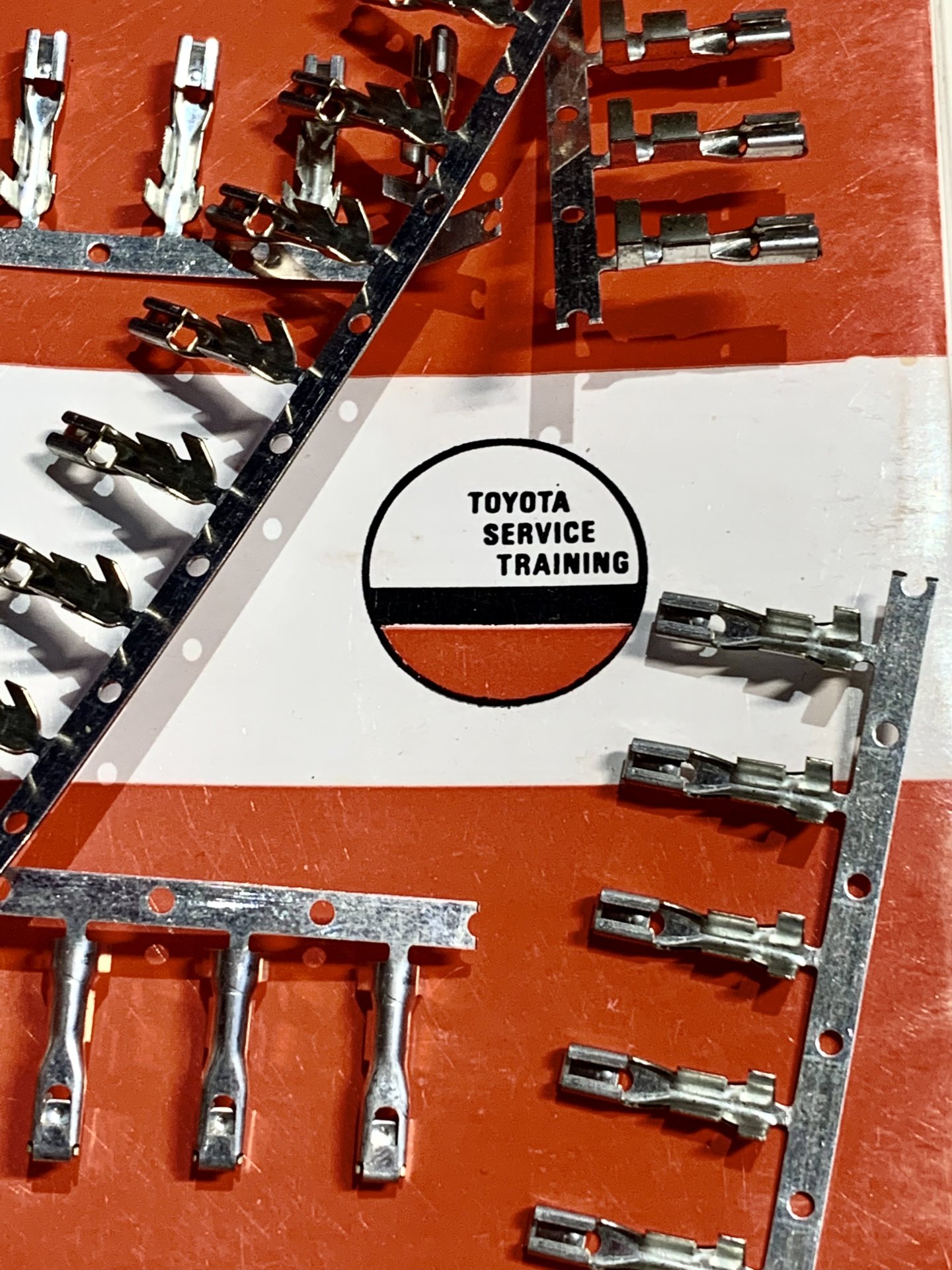

my suggestion would be to make a comprehensive one time Alacart list on paper of each and every electrical OEM toyota repair and service parts you require and then PM me the final revised version list of your needs and wants
I can help here ….
this is what I do ….
Please explore the links below …
I have only very recently started my own SKUNK-WORKS Brand and Line up of Professional Grade and Results electrical Repair and Service SST line up ..
- my new “ WASHER “ Kustom and high end yet within reach of most folks BRAND will be expanding and growing steady this early 2022
So stay tuned please and thanks for your support
- kindly
Matt

This orange doodad you’re holding in this picture is a grounding bus. The FJ60 and FJ62 have one of these monsters too.
It’s grossly inadequate for the task it’s asked to do — connect a bunch of ground wires from assorted electrical components together and route one wire to the body for ground.
This piece of junk has caused untold misery to countless cruiser owners when it eventually burns up.
The BEST way to deal with that abomination is to get rid of it entirely. Remove all the pins and solder wires to them then terminate them all to a proper grounding bus (blue sea has a nice one) you install up under the dash.
Mr. T figured this out in later iterations. Ground straps frigging everywhere.
