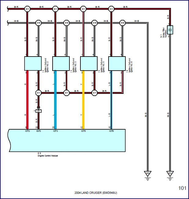

What were the codes? And/or which coils were at issue?

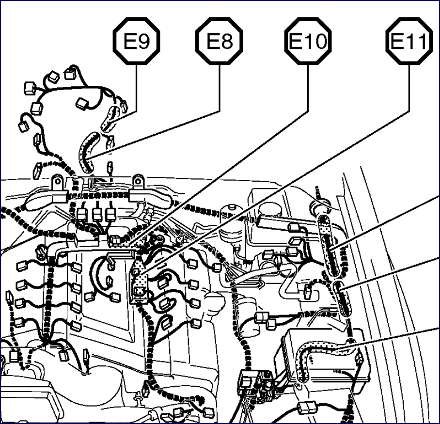

IN2 and lf1 connectors are behind the glove box. lb2 is behind the instrument panel.
E10 and E11 are in the engine bay. Appear to be near the valley. Could be under the intake? Someone with first hand experience can chime in.
View attachment 4161149View attachment 4161150
All 8 cylinders/coils, at different times, usually threw 4 codes at a time.
