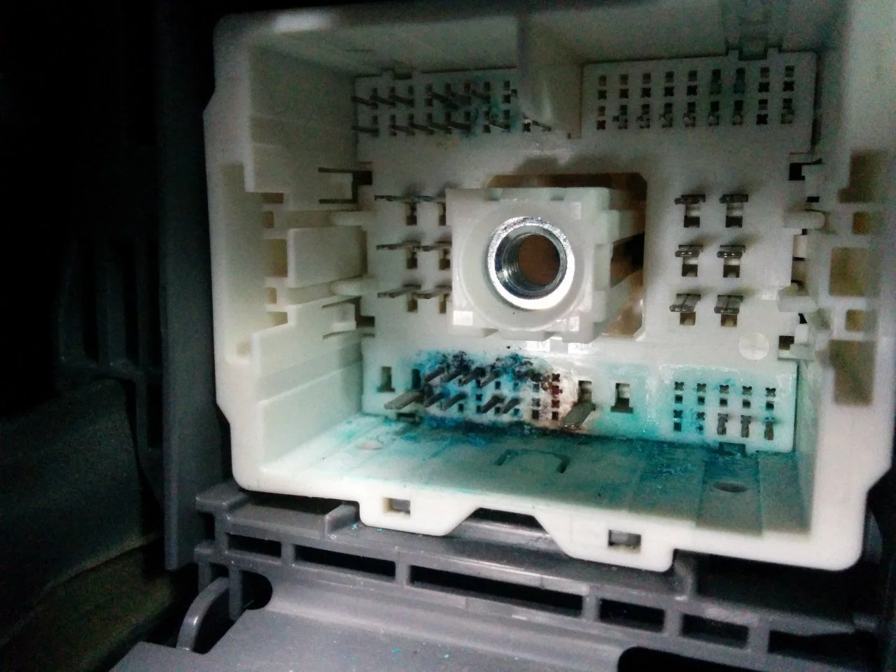

I had heard that moisture it in the wiring harnesses could be an issue. When I took the passenger side plastic step off the entire channel underneath was full of ice. As things defrosted i found water dripping down on the connectors on both the driver and passenger side. I pulled the drivers side connectors and cleaned them up - there was some bad corrosion including one pin that was missing completely. Have been nervous about pulling any of the other connectors until I have some spare pins & repair wires handy. In particular the immobiliser fault was likely caused by moisture in the connector under the glovebox.
Might just need to wait for rain and bury myself under the dash to try to find the source...
this is the lowermost connector on the drivers side.... One pin was corroded away. Another one was so weak that if bent when I tried to clean it. Fortunately the missing pin (68?) is not critical- it is on the interior light circuit.
