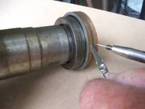

This is my way of checking the slip ring , press the hub lock button in , the light should come on for 4-5 seconds, press to release the button and the light should go for 4-5 seconds.
