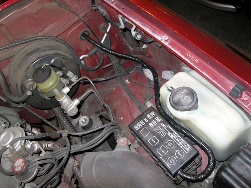

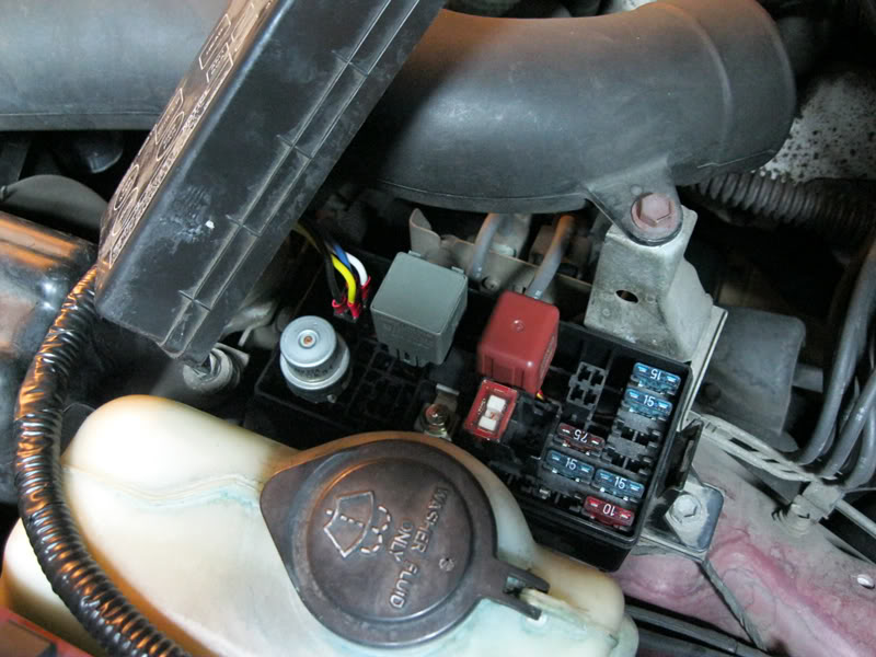

Thanks for the input. I relocated my EFI relay tonight.... only took about a half hour and was pretty much a free mod since I had some 12 AWG wires, spade connectors, and flex conduit.
I left the wiring in the engine bay alone, so hopefully just relocating the EFI relay will keep it from burning up in heat from the exhaust manifold, as it's now located underneath my dash.
I drove around tonight for about 20 minutes and the relay never got warm, but then it was 11pm at night and it wasn't hot out. My real test will be driving the truck to work this Friday (55 mile round trip) with stop & go traffic and using the AC. I'm really hoping this fixes my problem of an overheating EFI relay that kills my car when it's hot outside.
Here are the spade connectors in the fuse box. I had 4 different color 12 AWG wires, so I just used them to keep things simple when plugging it in.
I drilled a small hole on the side of the fuse box cover, and it doesn't stand out at all with the flex conduit there.
Wires in the flex conduit going to the firewall.

Covered the wires up underneath the dash with the flex conduit and covered the contacts, but left the metal cover exposed to conduct heat. Tucked it up underneath the dash so that the relay has plenty of space around it. Also very easy access if I need to ever change the relay out.
