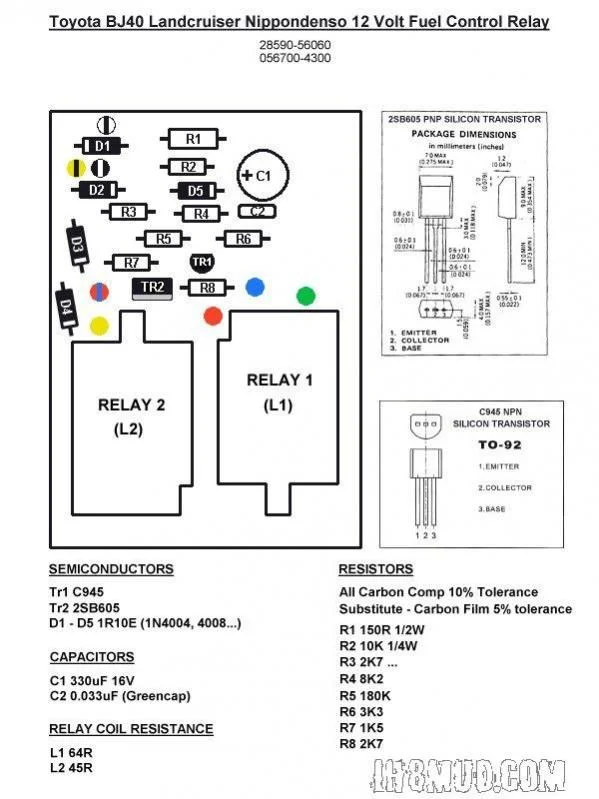

Amazing Bandit_guy! You have brought new hope to my relay woes. My edic relay just toasted out on me finally 2 weeks ago. After the nightmarish realization that a 24v pre-1980 relay was nearly impossible to come by, I found your thread.
Using Rockcrawler's awesome 12v relay write up, is there any way you could indicate what might be different in the 24v.
attachment.php
I would like to try and build my own, but I'm totally in the dark as to what I need to do so.
I don't know how good your French is but this is where the inspiration came to build my later modle relay.
http://www.serie4.fr/mecaniques/pdf/20101220091552.pdf
I didn't look too closely but I think aside of the from the coils the capacitors transistors and resistors should be the same.
What I did was use the old relay to map out the wiring diagram then figure out how to mount all the parts. If your old relay board is still in decent shape you could just mount new parts to the old board for an easier fix. The capacitors (the things that look like batteries), the coils or corroded parts of the board are the usual suspects.
Good luck with your build, I hope this helps

That clears a lot up for me Bandit. One of my relay coils is toast and the other one is not looking too great either. I'm going to try just replacing the coils and hoping the rest of my FCR is all good. My EDIC thanks you. Cheers!

Those relays are going to work fine. The 30 amp is the max current it can safely handle. You won't reach these limits. The one's I used are the sames as the one in post # 6 with the plastic shell removed and the leads cut up.
