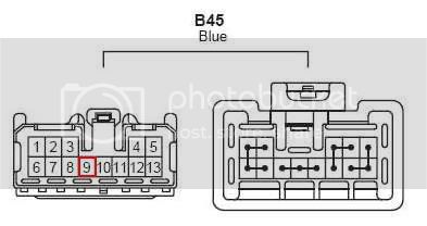

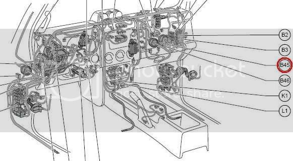

Look under the dash on the passenger side, you will see one of the main harnesses running through the firewall. Taped to it you will see a Blue Jumper (B45).
In this jumper are 3 White/Blue (W/L) wires, you need to unpin (or cut, or cut and put a switch in, which ever you prefer) the wire on pin 9.
If your looking at the wire side of the connector, with the release button on top, it will be the 3rd W/L wire (the one all the way to the passenger side). MAKE SURE you get the W/L wire on pin 9 if you get one of the other 2 you will have a X-Mas Light Dash!
That’s it! Your done!!!
This is a picture of mine after the mod. I put a switch in line so I could test it, the brown wire goes straight into pin 9. The 'aftermarket' W/L wire goes to the wire that used to be on pin9. Hope that helps...
