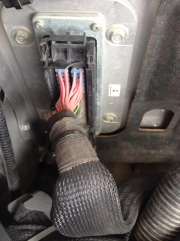

Hi all
Hoping someone can help me out hear run in to a bit of a stick situation . My ECU harness the connector that connects to the ECU has broken . Does anyone have an idea on where I can find one I have been to the dealer and they said I'd have to buy the whole ECU harness which is prototype pricy
I have vvti v6 4.0 . I've checked the fj but it has a different connector I think the 200 series would fit
Is there a 5 digit number molded on the back side of the connector? If so what is that number?
Right this is what I could find 90980-12396
Couldn't find any other number pls let me know if it's of any help
If that number came off of the broken piece that is the part number to order a replacement. It will be bare and the wires will need to be transferred over to it. So you need to visit your local dealer and request that number. It is alive in the US market with a published price of $25.40 (USD).
