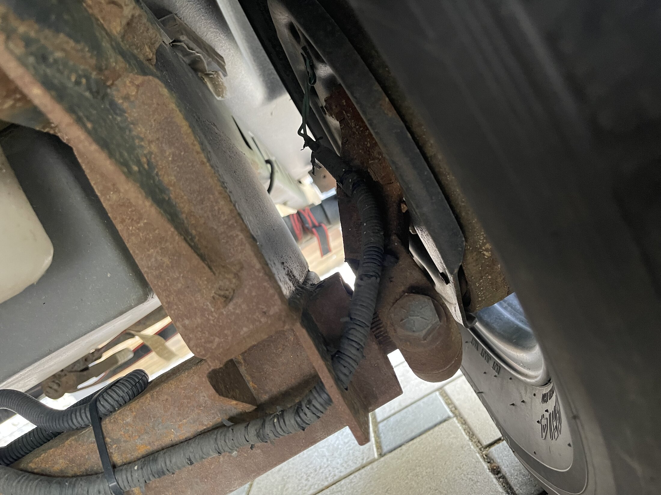

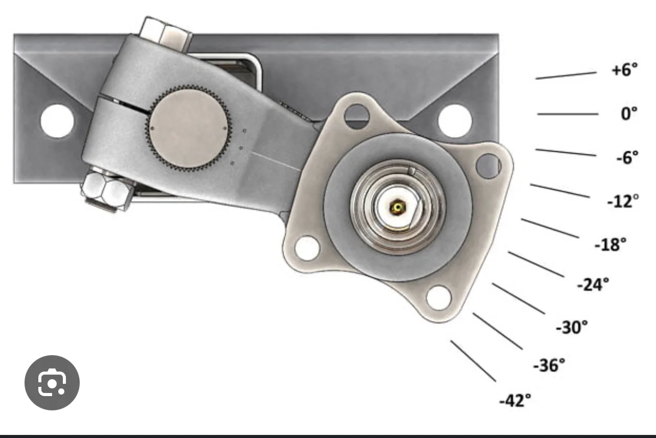

Hello! Was there a specific reason the shop had them installed with an up angle rather than the recommended 24 degrees down angle? I'm finding there is next to zero suspension to absorb the bumps and worry this is why. Also able to please share the pic when you saw it at the shop in its very high setting?
I'm aiming to upgrade the wheels and tires and figured step one was to change the torflex back to a down angle first.
Any help or advice would be appreciated!

View attachment 3947185View attachment 3947186
I don't recall the arm pointing up like that. This might have been changed after I sold it? // edit: Nope, earlier photos in this thread show that's how it came from the shop. //
The arm angle is adjustable - that's the beauty of that particular setup. Take off the wheel, and you will get access to the single bolt/nut that secures the arm on the spindle. In your diagram, that's the nut on the left of the picture, pointing down. Once that nut is loose, you can simply pull the whole arm towards you and it will come off. Turn it to whatever position you want, slide it back on, tighten the nut, put the wheel back on. This will change the height of the trailer. You can (for example) use this to give yourself more clearance in the summer, and less clearance (and overall height) for storage in the winter.
Also, as far as absorbing bumps goes - tire pressure is critical. Any time I'm off-pavement more for than a few kms, I air down all my trailer tires to 20PSI. Makes a colossal difference.
