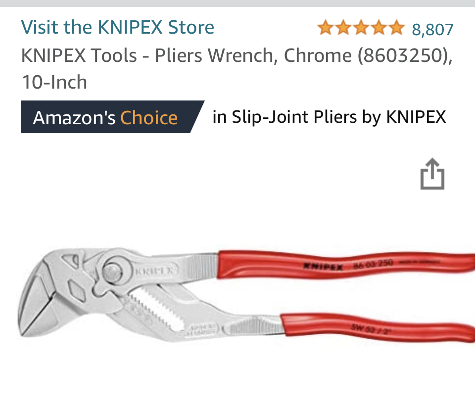

I do carry this 10” German wrench from Knipex that opens up from 12mm to 52mm and locks in a preset position for easier use on a bolt.
I hope this knipex wrench comes in handy when I don’t have the correct socket in hand.
