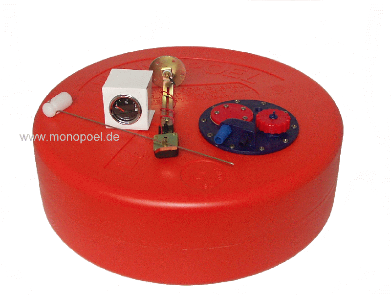

Just as a tip. Sometimes you're looking to put an extra tank under the car, either for water or for fuel.
If you are taking your spare wheel from under the car to a different location (rear bumper, roof, etc) then you can use the original spare wheel location for the tank. But it isn't easy to find a round one. I bought this one, which is pretty equal in size to most standard spare wheels.
It is 41 litre so it is not huge, but it will fit most cars without much work, and it makes for a nice extra range. Or a nice capacity for a drinking water tank on long trips.
150 euro from Germany. If you want to use it with water, then you have to get it with a different sensor for the level. They can supply it or you buy it yourself (saw them in a boat shop as well)
tank for spare wheel incl. fuel send unit and fuel gauge
material:
Eltex (PE-HD), suitable for gasoline, diesel and veggie oil
weight:
4.4 kg
volume:
ca. 41 L
diameter:
ca. 570 mm
height *:
180 mm
