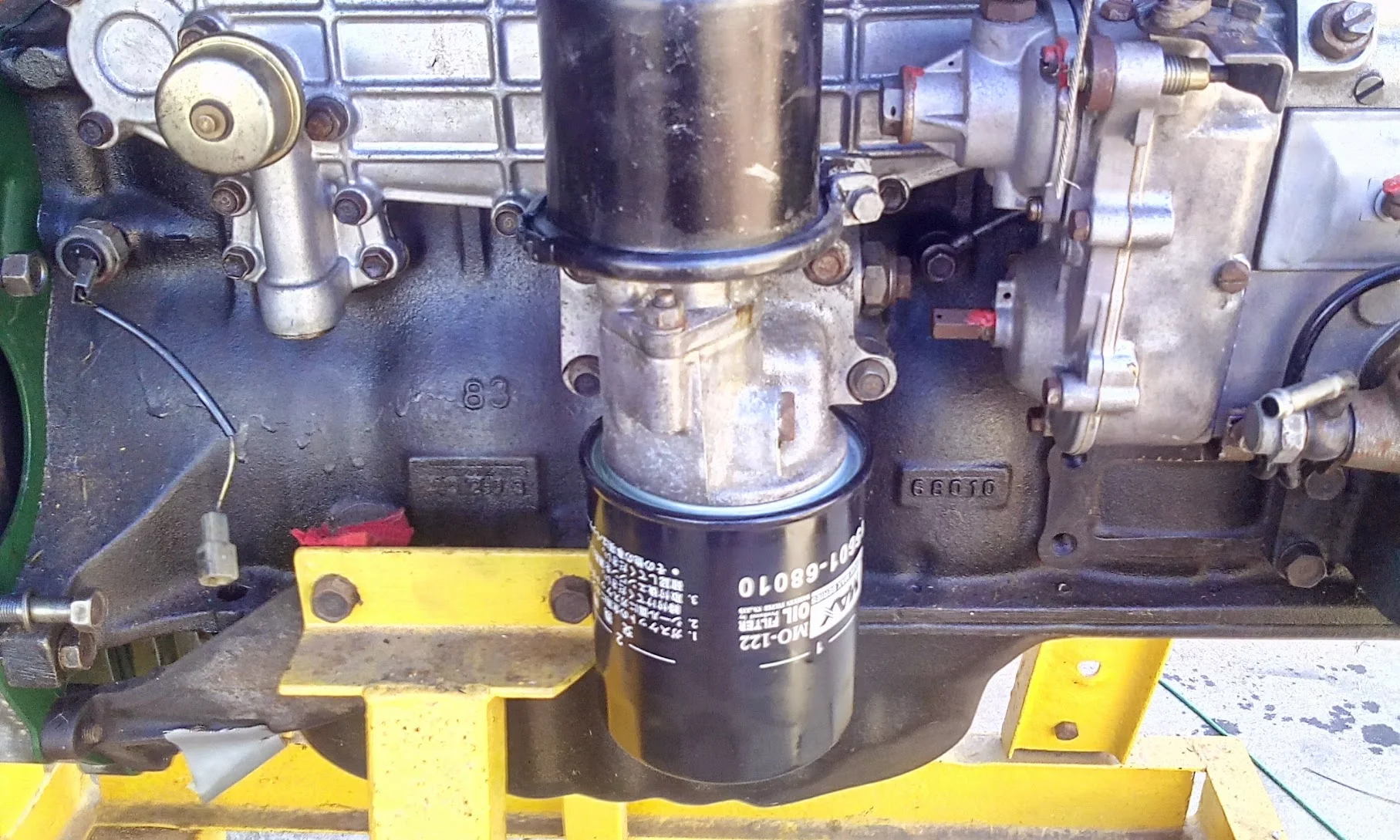

The "bracket" is in fact an alternative oil filter housing.. it will only fit on an early 2H and replaces the existing factory oil filter housing. The machining effort to replicate this would be significant. These are not difficult to come by in Australia but aren't really worth the effort of fitting if you're doing 5,000klm oil changes. I removed one my main travel vehicle as I was having trouble getting it to seal perfectly.

No, there's two versions of the oil filter housing for the early 2H.. one that has the centrifuge on top and one that doesn't. I'll try and get some photos in the next few days of the two versions.

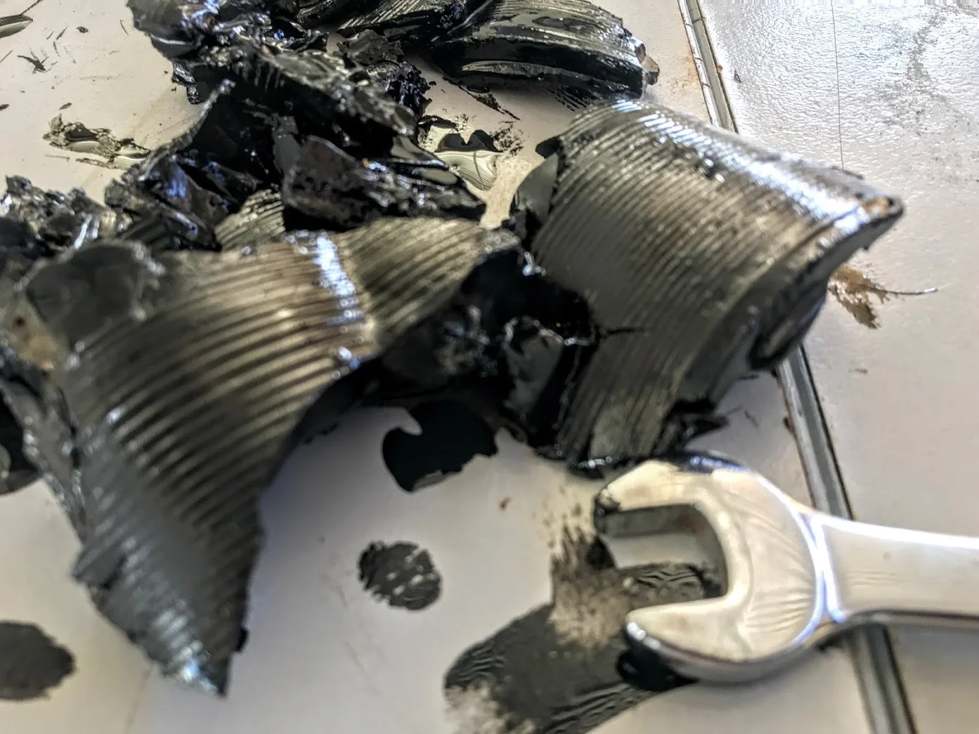

Practically -- true, I'm also doing it 5k km each. But I'm a man-child who wants a weird rare toy so I can feel good about myself :) And I bet scraping out the sludge each oil change and thinking how careful of an owner I am will make me even happier 😁
I totally understand and respect this! the sludge is nasty, here's some from a 2H I bought years ago. I suspect the centrifuge hadnt been opened since it left the factory
oh my, poor little thing
Appreciate that, thanks
