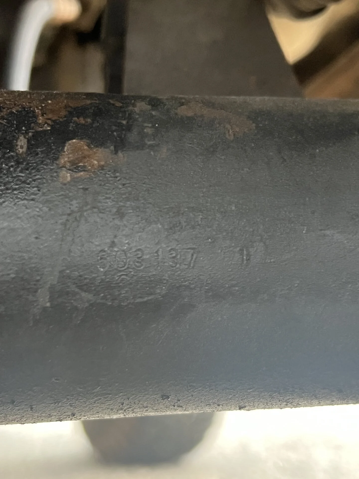

Is there a way to tell what Dana 60 I have?
Here’s the stamped numbers off the housing
Probably a modifed 60, ford 9" bearing cups to make it semi float, custom 6 lug axles, who knows what carrier and who knows which rotors were used ?

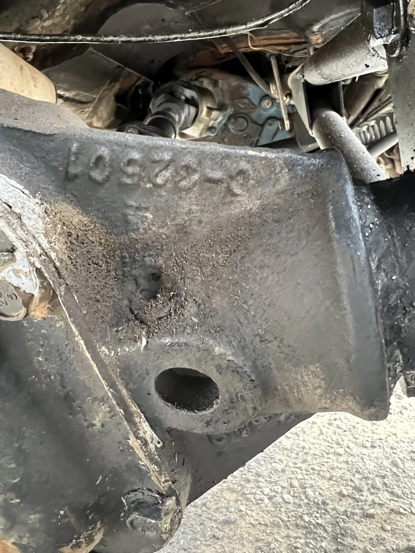

Maybe this will help. I tried looking up that number, but didnt come up with yours. Are there anymore numbers stamped anywhere?? Also, looking at those brackets, they look very similar to set I had from RuffStuff.
ruffstuffspecialties.com
I found this on the housing. I’ll see if google turns up anything

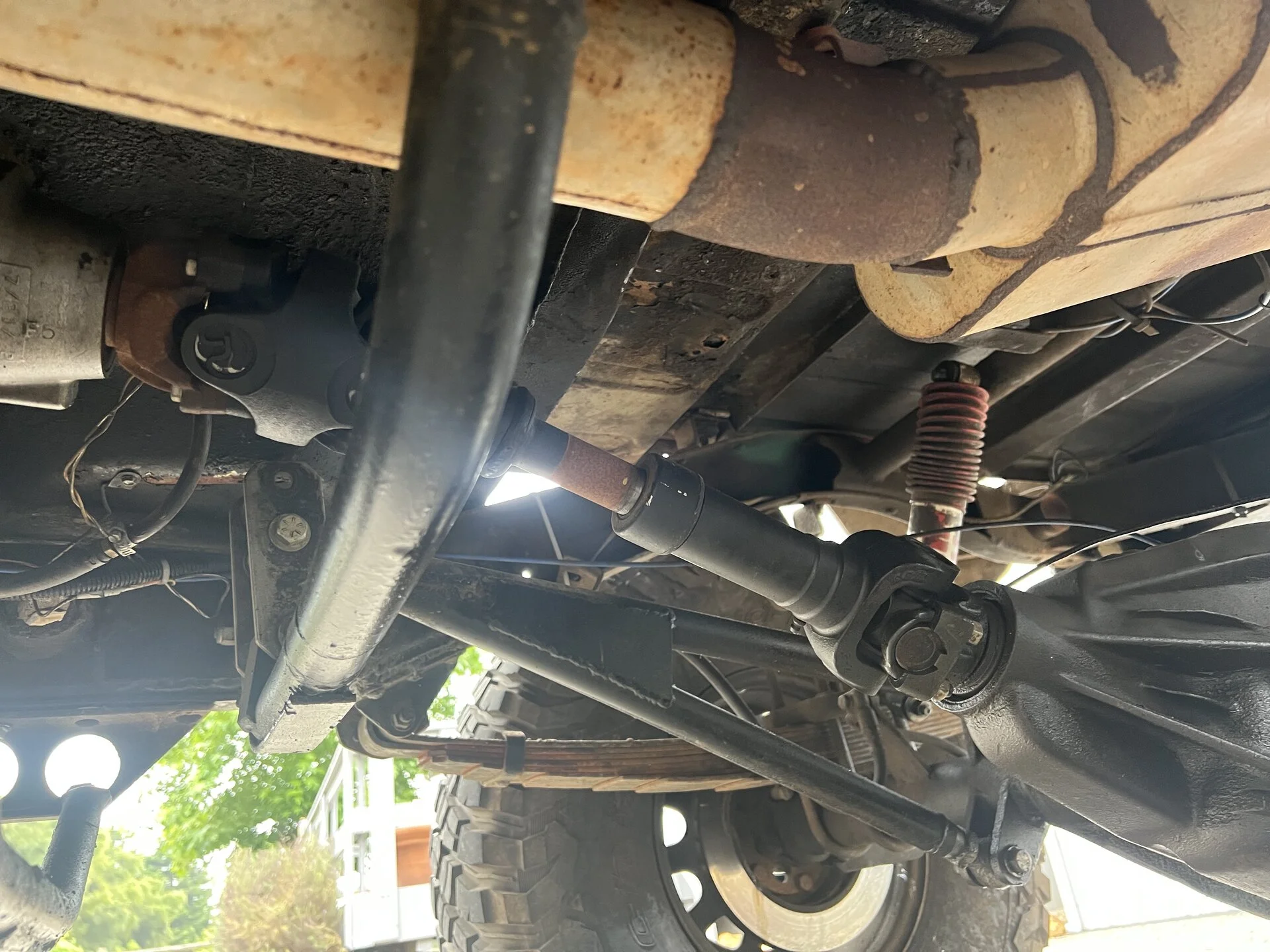

I’ve looked at those as well. I had to have a custom rear DC drive shaft made and seems like there might not be room to put a disc on the tcase but I could be wrong.

Rear drive shaft. Does it seem like there’s room back there to add the tcase brake? Do I need a longer yoke to install the disc?
Seeing the space you've got the e-brake calipers and cable may be the way to go and its a mechanical connection.
Ya that may be the way to go. I think I’ll end up with el dorado calipers and figure out the rest of the cables somehow
