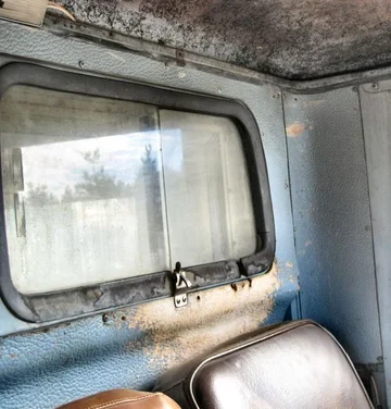

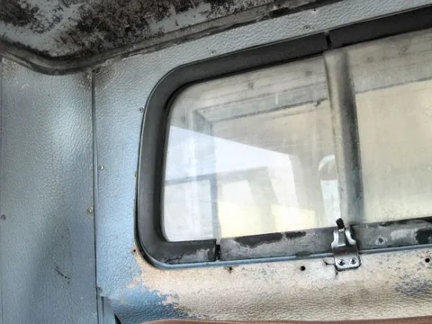

it is a textured chipboard
the texture looks much like leather
here is a pict of mine
WOW! I wondered what those small sheetmetal screws were around the rear window area. Looks like they had a purpose after all.

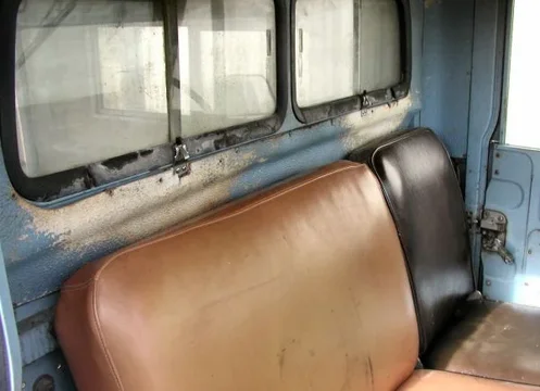

Sorry I can't help but............got any more pics of that stuff behind the seats?
Thanks.
looks pretty much the same all across the back & left looks like right side
