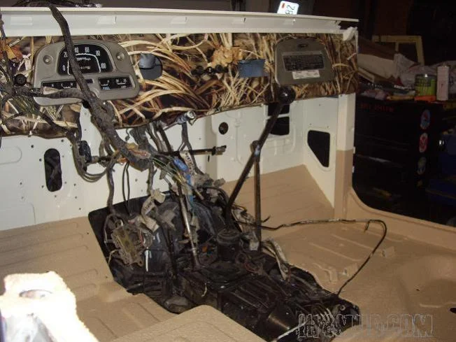

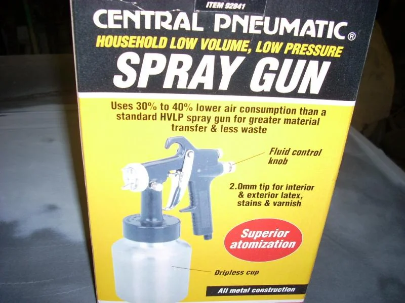

Here's a few pics of my 77 Bronco i'm doing a frame off resto on. I used Duraback on the tub and was really happy with it. The gun I used was only $14.95 from harbor freight. It was an LVLP gun, and worked excellent. I have $300+ primer guns which wouldn't spray the material out as nice. As far as prep before sraying it, wipe it with the previously mentioned Xylene. The manufacturer says to call before applying if the primer sufacer was epoxy based, but I decided to spray it anyway. I scuffed it with a sanding pad to give it some tooth. Still holding up now.
Looks good guys. How do you like the grey? The sand samples from Durabak don't come close to the tan on my 40 so I am considering grey or black. Seems that grey would look less dirty. Are y'all worried about what Durabaking does to the value of your 40?
take pictures of floor before the durabak shouldnt be a value issue unless its a restore to stock or if you do top and bottom people might thinlk your hiding something yoou might try smooth as reg is rough on the skin id do it again in a heartbeat
