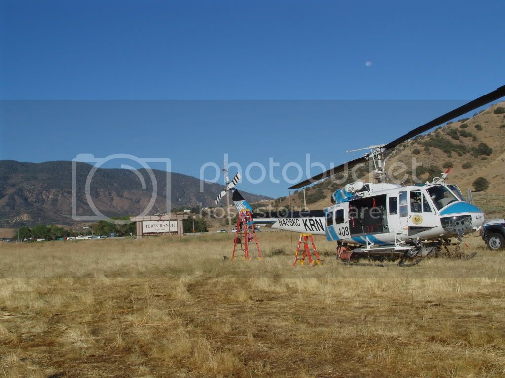

Sorry about the delay. I'm not sure if it goes any further when you roll it, but I have the tendency to roll it out too far making it thin. Spraying it is really easy and tends to go on more evenly. We use it on the floor of our helicopter and I can get an even coat on a 4x8 sheet of plywood with a half gallon that will withstand a stokes litter being dragged in and out and 9 pairs of Whites doing their damnest to tear it up.
No worries... I hear there is an inexpensive spray gun out there. Who makes it? How hard is it to clean after each coat? Nice Helo.....
