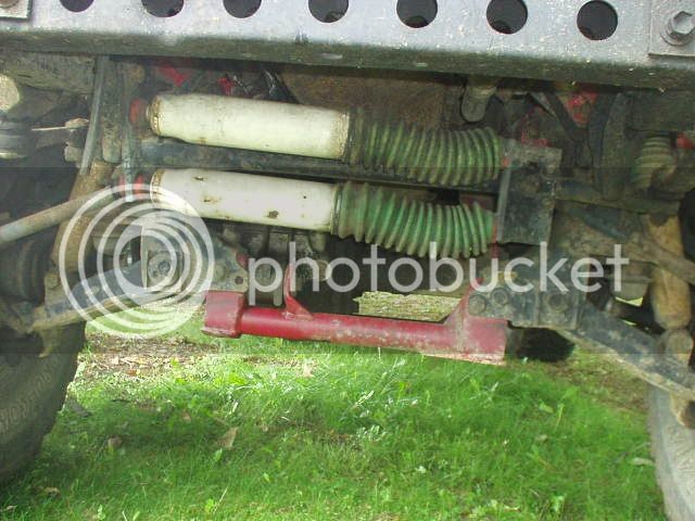

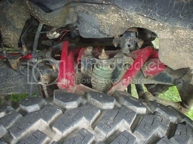

I looked at my pick up, I does not look like anything was cut off the frame. I did not get the 4runner yet so I have nothing to compare to though.
Here are some pic's, maybe someone can tell from them.

Can you tell from the pic's if its a bolt-on rancho or if stuff was cut??
It looks bolt-on to me, actually, but it's hard to be sure. I do see lots of idler arms in your future, maybe you can buy them by the dozen?
My opinion: Other than for poser looks, I see NO REASON to install an IFS lift like that. It doesn't increase wheel travel, and it puts a severe strain on your CVs and steering parts.
TT,...if you don't see any welds....

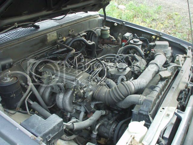

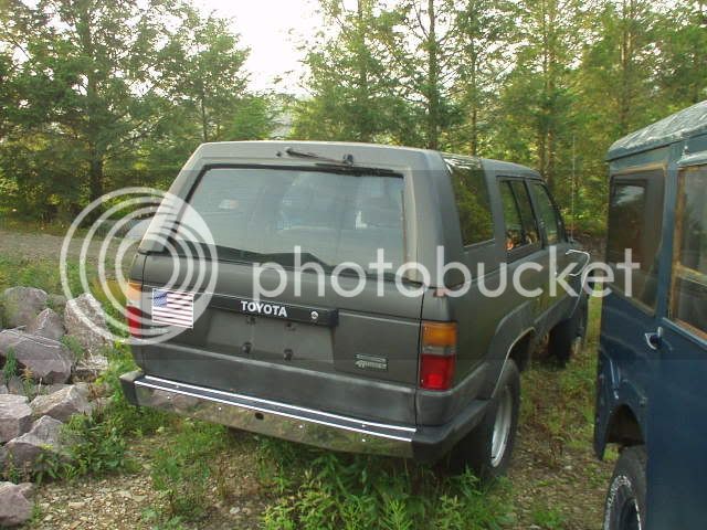

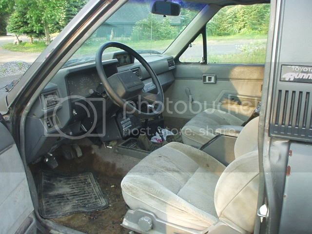

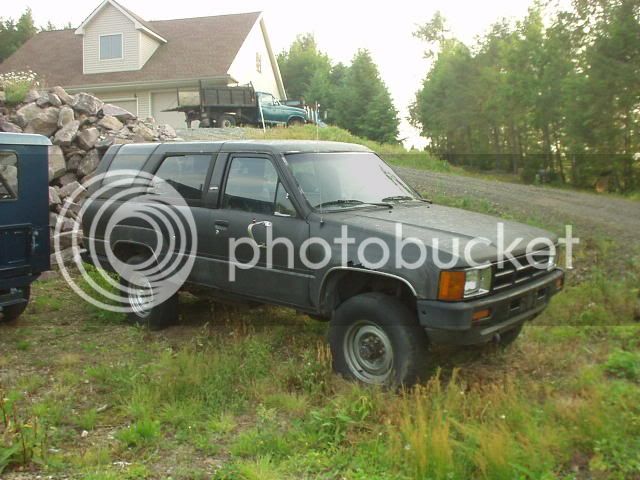

I looked at the 85 again tonight and took pic's.
Here they are, do you think its worth $400???????
The good side.
The bad side.

other than never washing it...it looks like its taken care of...nothings missing? The distributer cover is there looks like factory radio...
That thing is worth $400 for sure. I paid $1000 for my 84 4Runner in similar (RUST) condition to that. It ran like a top so I didn't mind all the rust. That is not an easy vehicle to come across, rusty or not. One thing about it though, is check the frame rails really well. Bring a hammer and a punch/screwdriver and pound on that puppy a little bit and check for soft spots. That thing could be relatively worthless if the frame is about to give out.
