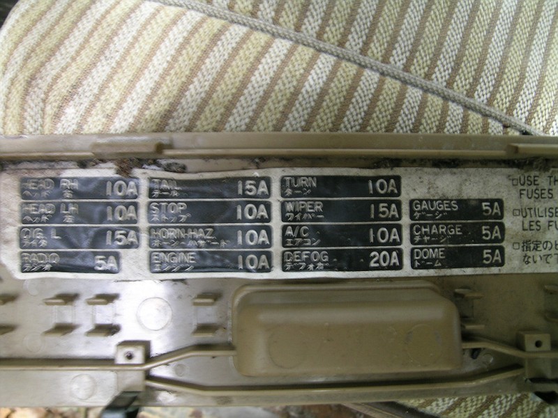

My defroster / heater fan went out, so I decided to check the fuse.
Where the hell is it? :o
The back of the fuse box cover shows it to the right of the others.
:confused:

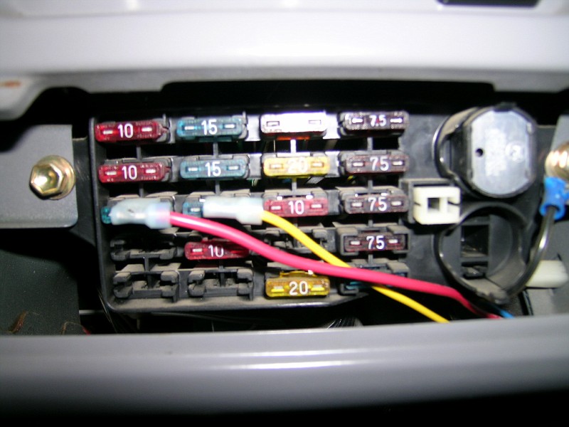

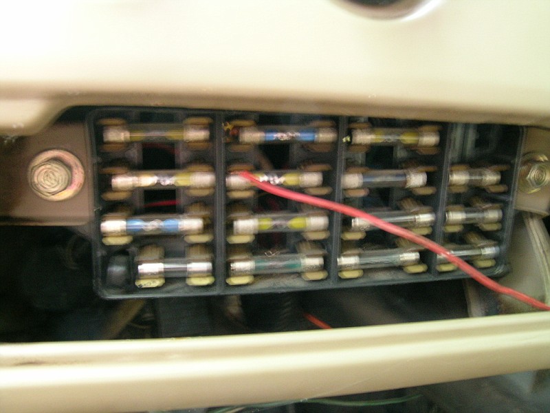

I believe you have a later 80's ATO fuse cover on an early 80's glass fuse 60.

From my 1981 mouse motel parts truck -
From my 1987 -
Wow! Thanks a lot. That makes sense now!
I think the fuse box changed sometime in 1983. You most likely need to reset your circut breaker. It is located under the dash to the left of the steering column (Fuse Box side). It is round and about the diameter of a quarter with a small hole in it. push a paper clip into the hole and you should be good to go.
Dynosoar:zilla:
I have glass fuses on my '82 as well.
