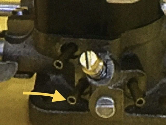

I'm only familiar with my '78, but I think your ported vacuum should be near your idle-mix screw.

I always assumed the vac advance port (Gold arrow on pics) on my ‘78 carb, was ported vacuum... this thread talks about the vac adv port and refers to it as ported.
My oem dissy pulled vac adv from the vac adv port... I connected my dui to the same port.

I can tell you, I accidentally swapped vac adv and TP once... it ran great, but required choke to start... even when warm.
