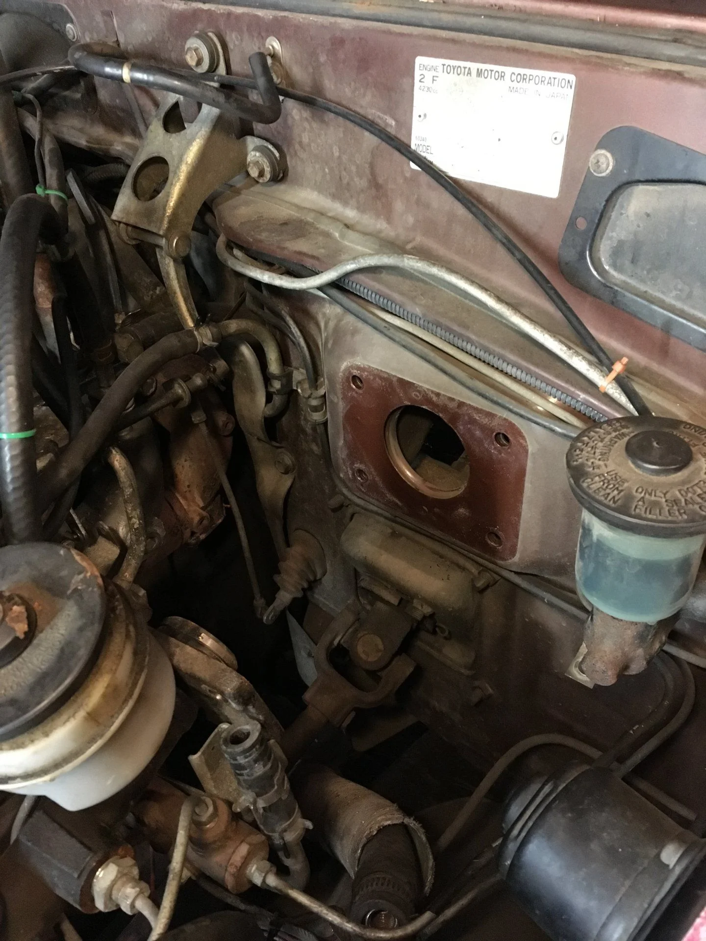

Follow the steps in the above guides to remove the 4 12mm nuts holding the master to the booster, I also needed to remove a 12mm bolt on the firewall that retains 3 of the brake lines to allow for enough freedom to gently flex the master toward the front of the truck. Then go into the driver's footwell area and locate the connection between the pedal and the booster input rod:
2032763

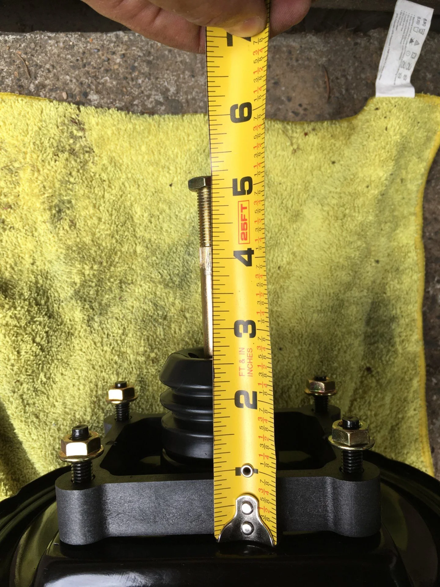

Remove the spring cotter, then push the connecting pin out of the yoke. The booster can now be removed from the firewall. Measure the distance between the firewall mounting surface and the yoke-jam nut interface, in this case mine was 4 1/2". Transfer the existing yoke to the new booster and set it at the same measurement. The City Racer booster is supplied with a spacer, but on the 60 it doesn't appear to be required, nor is there enough input rod to reach the matching measurement. I removed it.

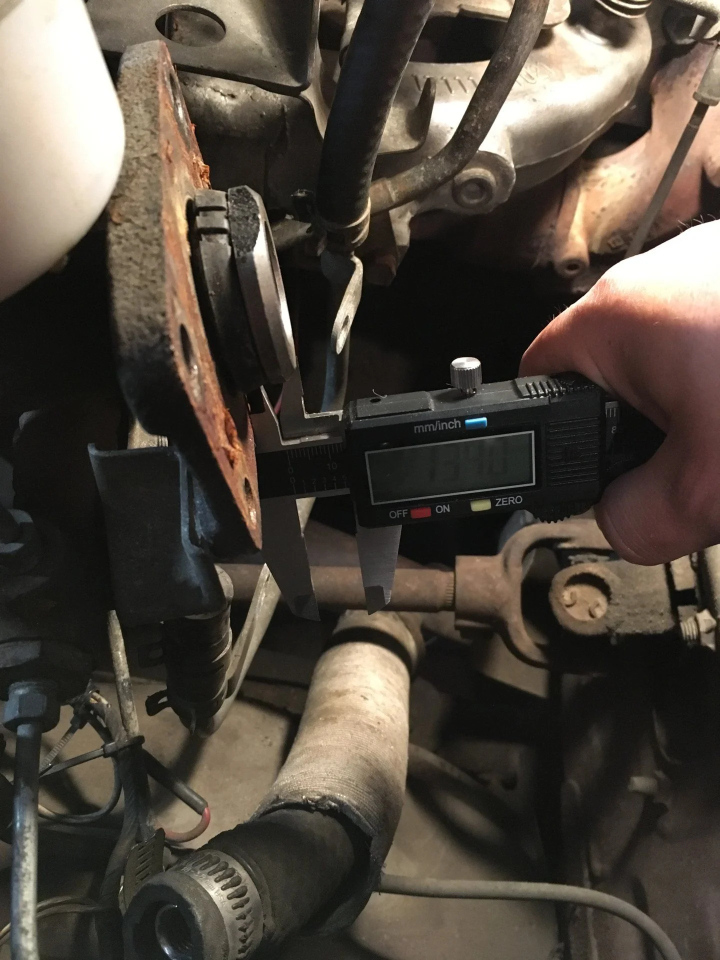

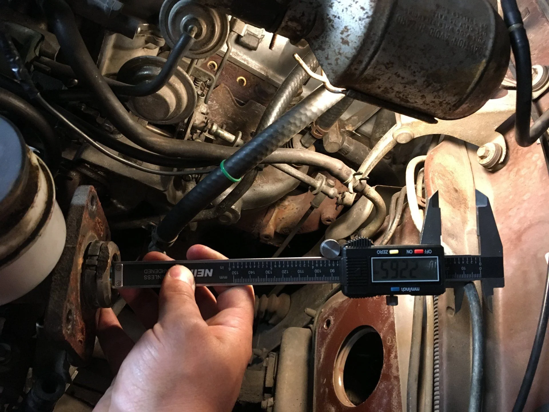

Next you'll need to adjust the booster output rod to master interface. Appendix 2 and 3 in the City Racer install guide lists procedures to do this. I opted to use a digital caliper and method 3. The critical dimension is the booster/master mounting surface to the tip of the booster rod, which must have 0.1–0.5mm of clearance to the master input piston.
First measure the max depth of the input piston to the extended nose on the master:
2032791
Then the distance between the mounting flange and the extension:
2032792
Subtract the second measurement from the first to get the rod extension. In my case it was 8.6mm. Then I adjusted the booster output rod to be 8.7–9.1mm from the mounting surface of the booster. To minimize slop in the brake pedal, try to keep the measurement closer to the low end of the tolerance spec.

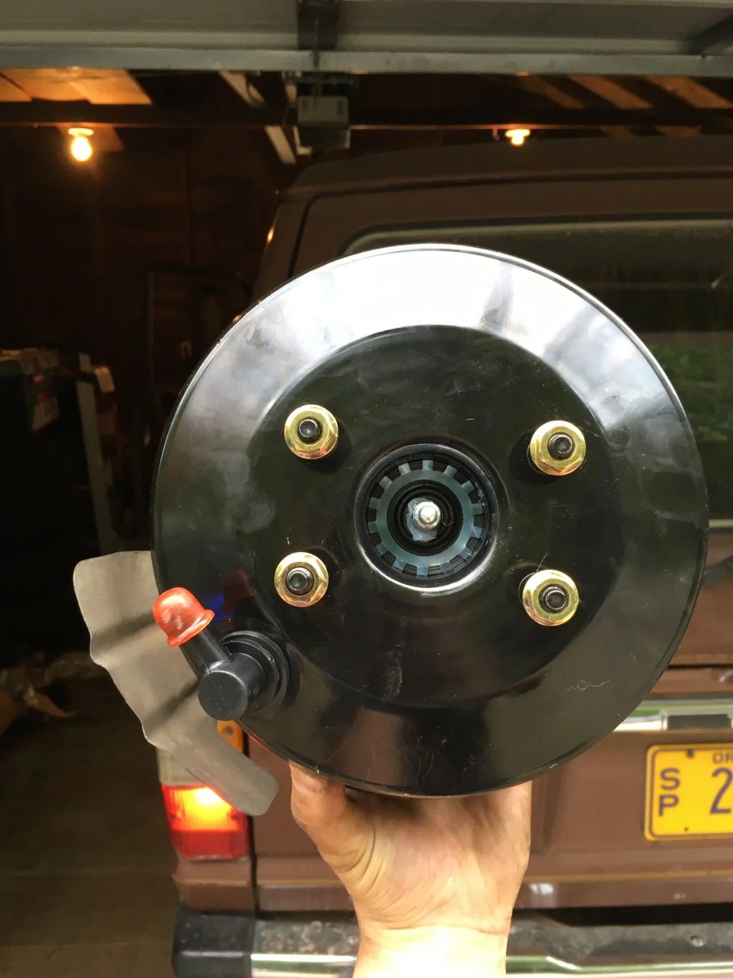

Now you're ready to install the new booster. I transferred the heat shield from my old booster and realized the arrangement of the 4 mounting holes and input bellows meant the new booster installed with the vac connection 180º from the old booster. Note the center hole is closer to the top two holes than the bottom two. Ensure when you dry fit the booster against the firewall that the yoke fits over the brake pedal, the pedal connecting pin fits in its place without depressing the input rod, and the brake light switch operates correctly— if the yoke is too far down on the rod, the brake lights will be on in rest position. The switch itself is adjustable if you need to tweak this, but I adjusted the yoke position on the input rod until the pedal sat softly against the stop. Remember to re-tighten the jam nut.
The new mount hardware is 13mm rather than 12mm, but otherwise it installs the reverse of removal. You might need a deep socket due to the longer studs on the new booster. I used a combination wrench.
2032812

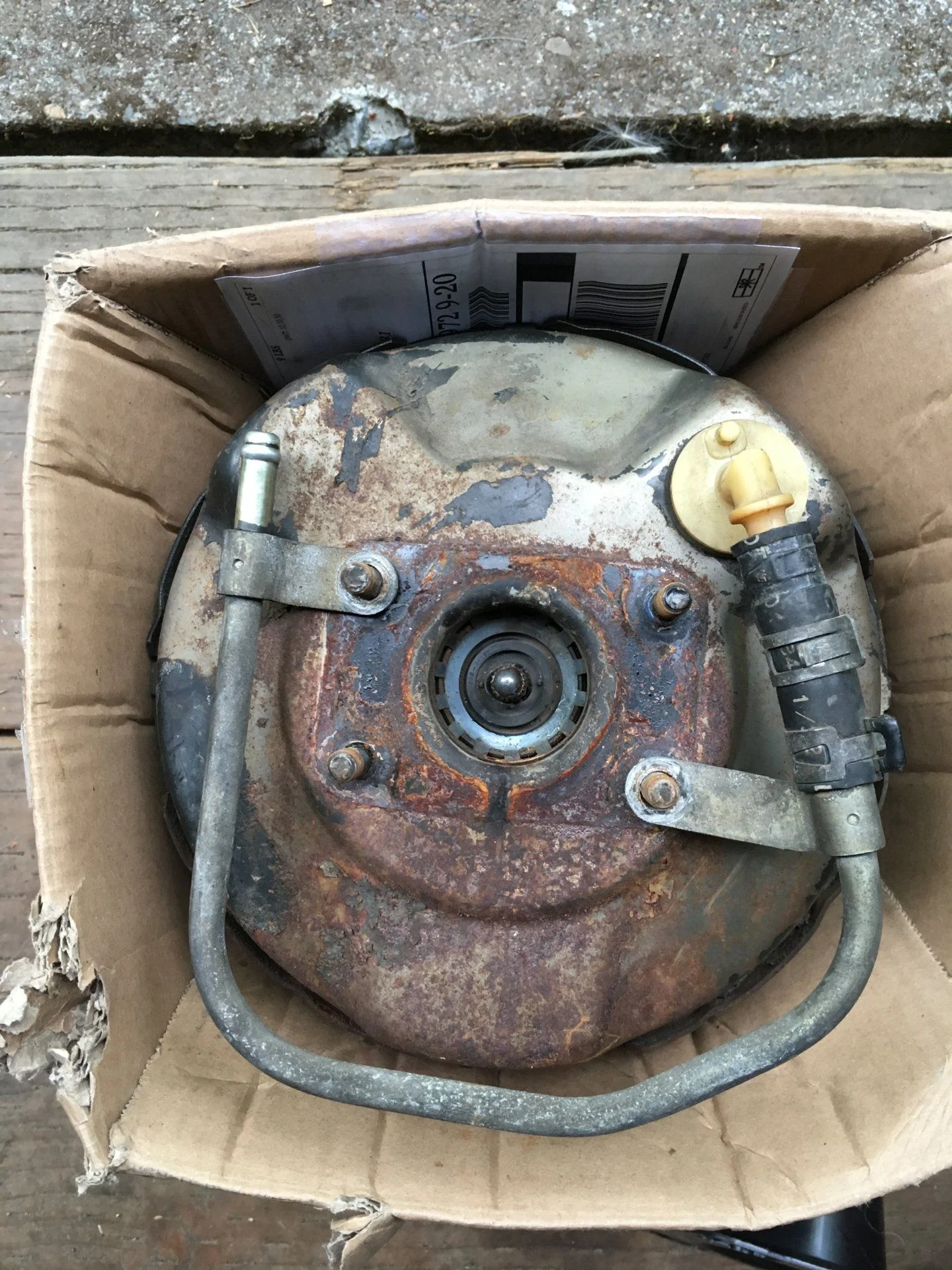

Note on the vac routing on the new vs old booster: the guides say to install in the same orientation as the old one, but there's only one orientation of this part where the studs and input bellows will align with the holes in the firewall. So if you have the arrangement shown on the right, you can delete the U-shaped pipe that loops below the master and connect the main vacuum line directly to the check valve on the left. On my truck that vac hose is quite stiff and is taking a lot of gentle persuasion to fit over the plastic vac nipple.
2032806
2032809
