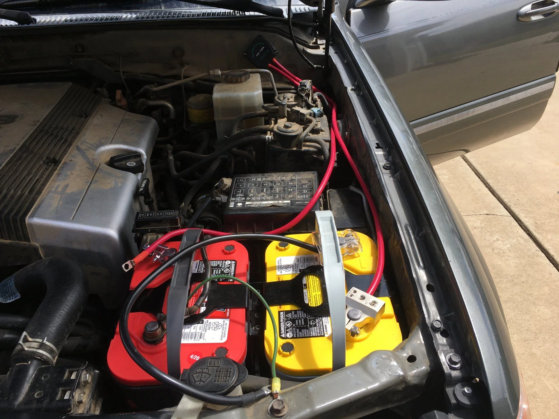

I installed a dual battery system where the original battery goes. The bracket is off Amazon. It's a tight fit, but it works. Just move your fuse box and the one with all the hoses back a little.
Dual Battery Tray
Sadly, I couldn't find a group 34 or 78 battery that would fit the bracket (even though its in the description) other than the optimas. I took the bracket to O'reilleys, autozone, walfart and costmo. None of their other battery's would fit. I guess optimas are shaped differently than standard batteries.
