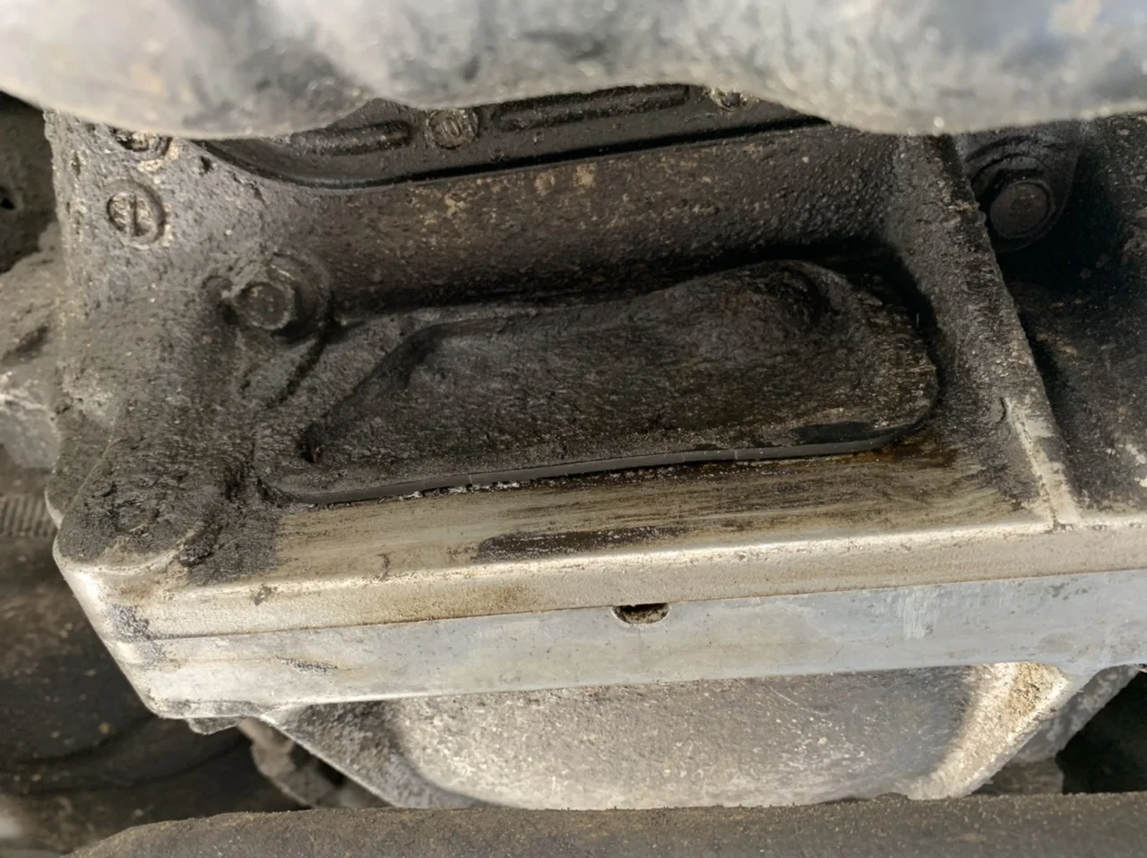

Here’s a shot I snapped a couple months back when I was trying to find this plug’s replacement. You can see the wiped area I just hit with my finger rear quick.
