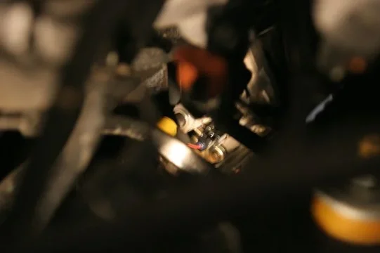

I noticed the other day that the coolant was low. I refilled it. Went wheeling. Now tonight after work I noticed drips coming up the driveway, and a puddle under the 80.
This leak is located on the drivers side directlyh above the starter motor. It looks like a compression fitting with OEM corrugated protective tubing. Basically I have a stream running out termination of the corrugated protective cover and the fitting, when RPM's are above idle. I haven't seen this one before so I tried a search. But PHH kept coming up. This is not a PHH, it's something else. I'm getting ready to break out the FSM, but I also need to get the kids to bed, right now. Thanks for the help. I'm going to break out the FSM after storytime. Someone probably be able to identify quicker.
The corrugated cover has the yellow tape in the photo. The tubing I thought was the starter wire from the battery. I'm really not sure what is going on here. Is there a coolant line somewhere in that corrugated hose upstream??? :confused:

BTW, those are really crappy pics and I can't tell what you are showing us. There are no Toyota factory cooling lines in convoluted tubing. It might be leaking elsewhere (like a temp sensor) and flowing down the tubing.

It's either the PHH, or one of the cooling lines going into the intake manifold or the throttle body. Lots of cooling lines going in that area.
Double check that everything is cool with the heater valve at the fire wall, just for s***s and giggles.

It's either the PHH, one of the throttle body hoses, the throttle body, the head gasket or a cracked head/block.

Sorry, back to the subject at hand. Upon further investigation (after kids bedtime and a firecall) I located the leak. It appears to be the PHH. :censor:What are the odds??
A perfect stream, and I mean perfect stream, is shooting out of a PHH pinhole right at the split in the corrugated insulation, filling it up then it runs out the end. Hence my confusing post. SOB!!!
