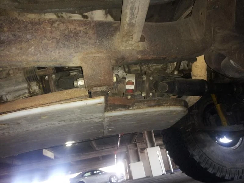

You need a two piece driveshaft with a carrier bearing, you could probably modify one from the rear of a longbed mini-truck to work for you
Bingo.
Both my 40 and 60 have two piece front driveshafts. They work great.
Mace, do you have a build thread on the 40 that shows the 2 piece drive shaft?

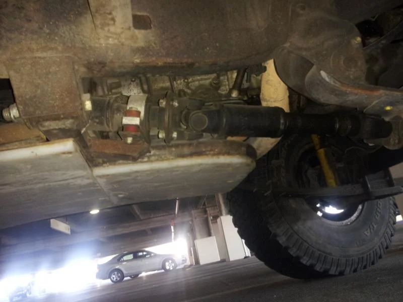

yeah, in my 40 and 60 series threads there is one. But it's honestly easier to just grab a new pic.
One sec.
Crappy cellphone pics
Mace, thank you for the pics. Gives me some ideas.

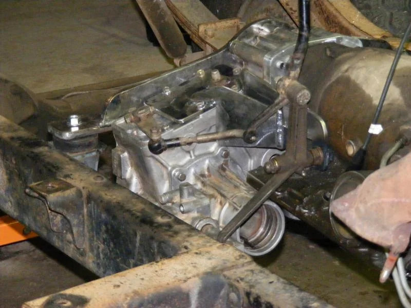

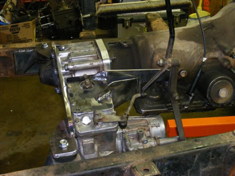

Here are some pics of what I've got now. If I go 2 piece, I could probably build something off of the trans cross member for the bearing.
Pic1: looking at the t-case
Pic2: side shot taken from the driver side
Pic3: straight from the bottom
Drive shaft is as for up as I can get it before hitting the pan. I'm about 1/2" from lining up the drive shaft with the diff flange.
I have a similar issue on my 40 with a 700R4/4L60 with an early Downey adapter plate, so things are REAL tight. The marks on your photo #2 represents pretty much what I took out of my oil pan. Basically I took about a 40º wedge out of the pan down the most of the length of the left side and TIG welded in a new piece. Just be sure you clear the internal components (i.e. valve body, etc.). The good news is there is less travel on the upper end of the driveline then at the axle.
