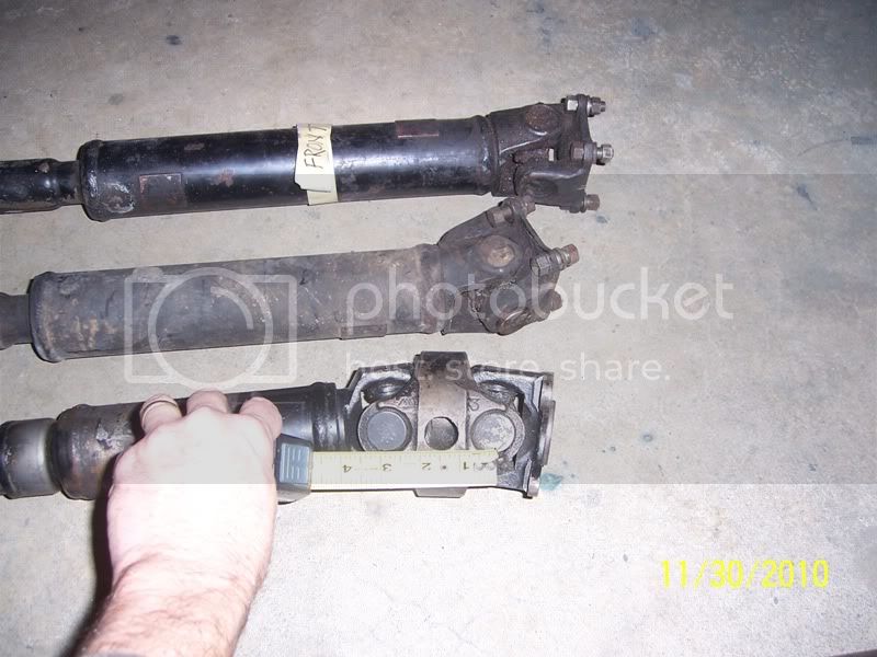

Thanks for your reply Dingman. I am not positive from your pictures, but mine looks more like the IFS one in your pics.
Edit: Never mind. I just noticed the ears on the flanges on the IFS shaft. Mine does not have those which suggests I have the SFA shaft instead. That is what I thought I had. This helps to validate that.

Here's a couple pics I have laying around... don't know if it helps you or not. (pickup\4runner shafts here)
on the left is a IFS front shaft, on the right is a SFA shaft. You can see how the SFA CV has a greater operating angle.
The easiest way to tell a SO shaft froma n IFS shaft is the "tittys" on the side of the CV flange.
All the CV shafts will have a protrusion of sorts on the side of the flange while a solid axle shaft will be flat on the sides.
IFS shafts/CVs are worthless.
