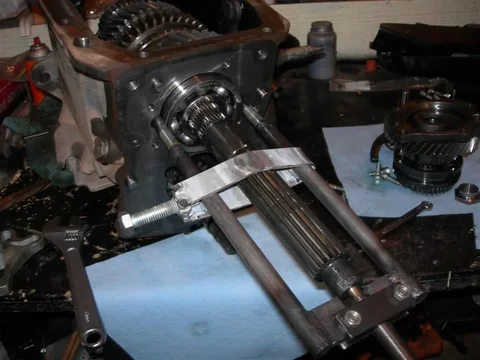

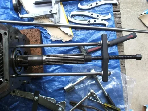

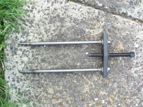

Couple of pictures I've found on here of custom built pullers for H42 or H55 transmission bearing output shaft bearings.
Seaching on....
