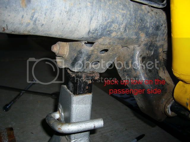

3. adjust the jack and jack stands: driver side high, passenger side low. that way, the panhard rod has less tension on it.

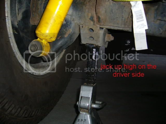

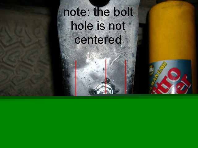

5. put the bracket in temperarely, with the stock bolt. mark the location of the holding bolt hole using the bracket as templet, take the bracket out, drill the hole on the frame. location is not critical, as long as you can put the bolt(comes with the bracket) through. put bracket back in for the last time, bolt on. don't tighten it all the way down, do it later. fail to do so, it will cause the bracket too narrow to fit the panhard rod.

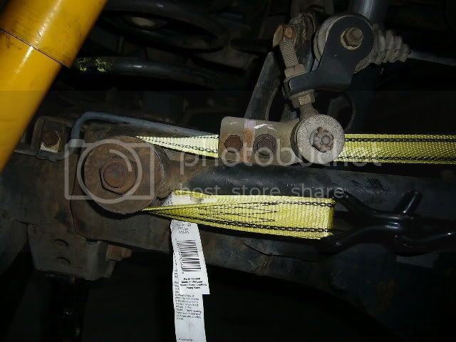

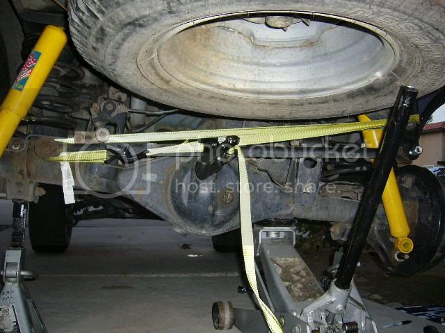

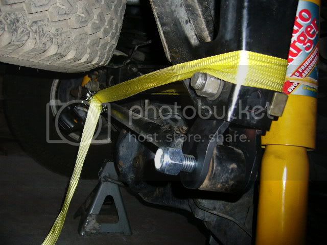

6. ok, here comes the hard part, putting the panhard rod back on, specially i'm doing it all by myself. that's where i spent most of the time scratching my head. because it seems the rod is half inch too short, and no matter what i do, it wound line up with the bracket. finially, i got a great idea. i use a set of good 1500lbs rated tie-down to pull the bracket and the rod closer, using the tie-down's rachet to get where exactly i need it to be. pi-cia-cake.
7. tighten the bolts in this order: rear shock bottom bolt, panhard rod bolt, bracket bolt, holding bolt. basically, from bottom to the top.

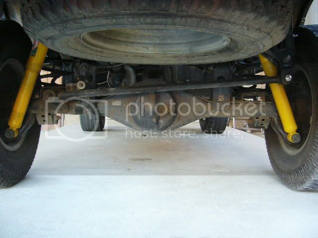

here is the after:
i'm going to swap the springs to OME's, which are 2" shorter than the FJ80's. the panhard rod should be right where it should be after that.
