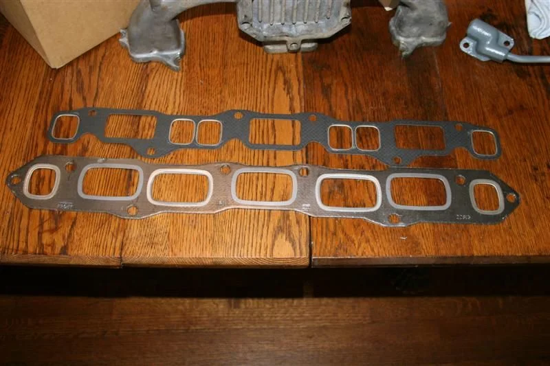

Also, I have both the felpro gasket and the OEM gasket in front of me. There is no difference as far as I can tell. Same material, same thickness, same flexibility. Am I missing something? Another strange thing is that the felpro gasket kit also comes with the heat riser gaskets, except that they are not the same material as the manifold gasket. They are that crappy foil sandwich like the SOR gasket. The OEM heat riser gasket is made from the higher quality material. Does all of this agree with your experience?

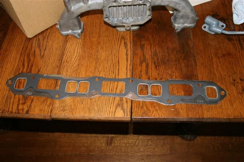

Just for comparison... a pic of a Felpro gasket and the one that came with a header from MAF
