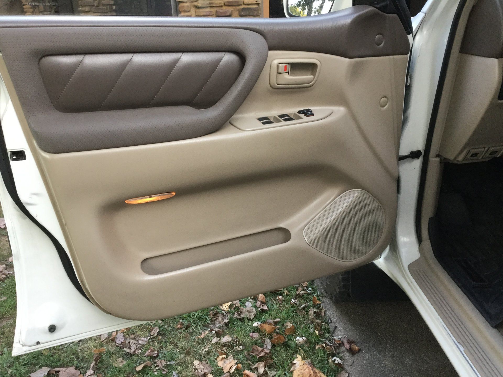

Finally got around to a speaker repair and grill recloth today. Both mid-bass foams were basically gone, and my right grill cloth was completely missing. I bought the following fabric to replace both sides (and eventually all grills) so that they would match:
As you can see from the picture, the color is not even close to oem. It is much lighter in person than the pictures show online. (I cleaned the old fabric; it is hanging in the pocket for color reference). However, my lx is Sand Dollar Pearl, and that match is pretty close so I am fine with it. Total cost for a yard of fabric (enough to easily cover all of the grills) was $20 not including glue. I used the glue included in the repair kit and it wasn't to bad to wrap. I used my old grill cloth as a stencil.
Can anyone confirm sr5pickup's rec for SEM lt. oak? is it a good match for Ivory?
His came out great... but my '98 LX speaker grills look different under the fabric. May want to check yours.
