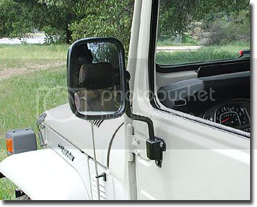

These are the euro/aussie mirrors you mention..... They look good, but will cost some coin. But, like anything else, if you want them, you'll pay for them.
Yes they are pricey, but probably the quickest solution for the later door.
Here is the original next to the new, of course it would have mounted on the hinge, but you get the idea. Sorry for the poor photos, had to put the phone past my ear to get the perspective right.
A comparison, right to left, new to old. Like I said before, they are only 2-3 inches wider than what I had, but I do like the view.
I'll take a better pic of my plate and the bolt pattern. They are almost bolt on, except the holes in the new mirrors are about one bolt width too wide, otherwise they might have bolted right to the hinge out of the box. I need to paint my plates, but the rain let up so maybe I will mount the drivers and try it out too.
What are the measurements of the mirror head?
I forgot to measure, but the ad said 6x8 inches for the mirror head. I think that is what the chrome ones are I have now too. Benefit is that they are convex.
Those latest pics prove the superiority of your new mirrors (in both "looks" and "being fit for purpose") MoCo

on 1st appearance they look little long, but as Tom says its the newer truck bias ... I think they look good ... I'd leave them as is ...
