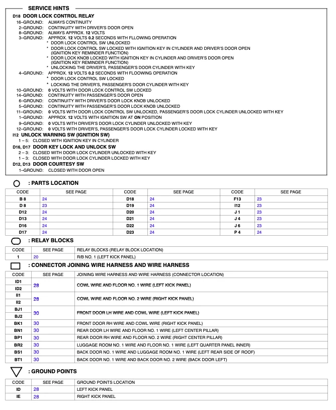

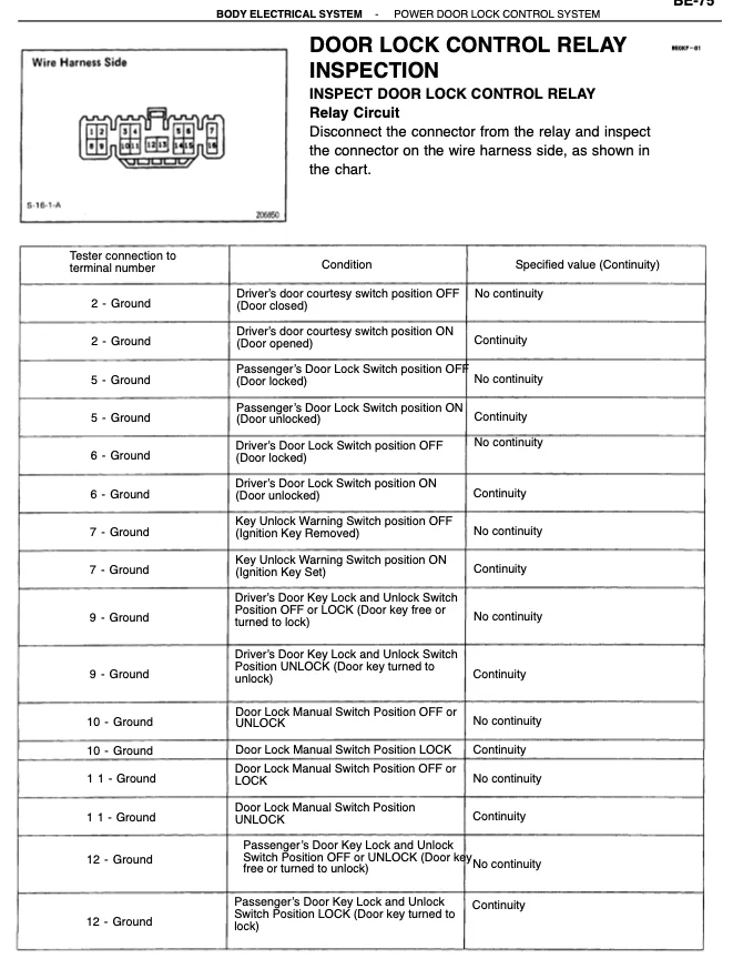

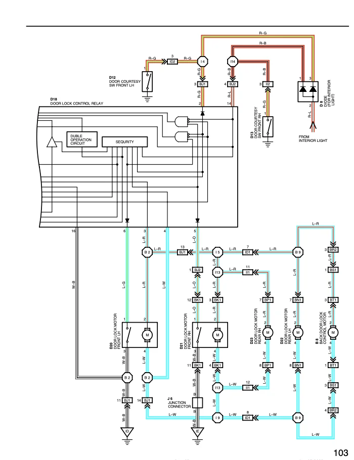

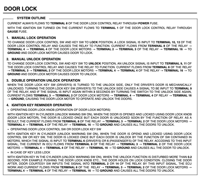

Some info from the FSM that may help me or others in the future:

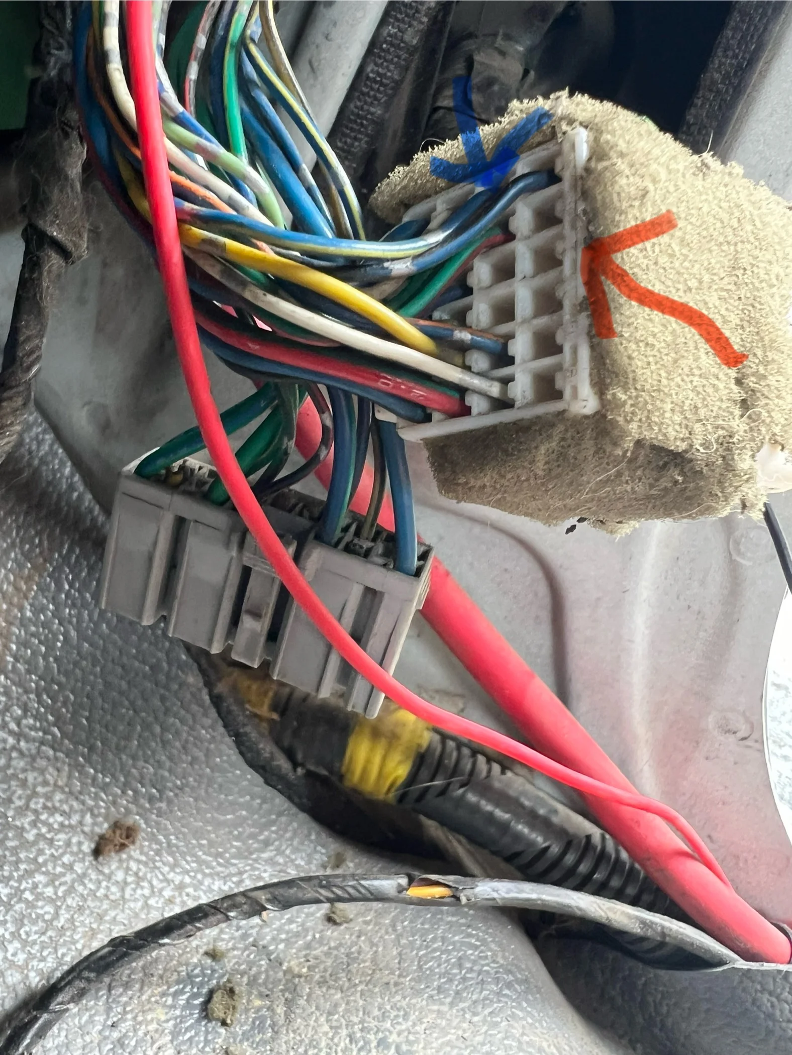

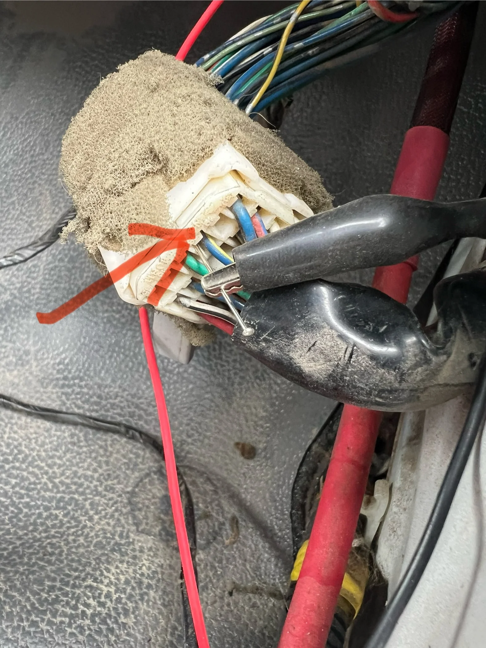

What I found through lots of testing of wires and connectors was that all of the individual segments of wire had continuity when broken down, but there wasn't end to end continuity when all of the connectors were plugged in from passenger door switch to driver door relay.
What I eventually found was that the "unlock" wire location on the passenger kick panel multi pin connector male pin was not lined up with the female side. The unlock signal was getting interrupted.
So I depinned the wire (blue/yellow) on the male connector (body side) and moved it to the location that would line it up with the female (door side).
I could have done it the other way (and maybe should have, maybe will...), but for diagnostic purposes, this solved the unlock problem. The door now locks and unlocks as expected from the passenger door switch.
My theory (not researched or validated yet) is that this door and it's wiring harnesses came from a different year and although the connectors physically fit together, the wires aren't all in the same pin positions.
