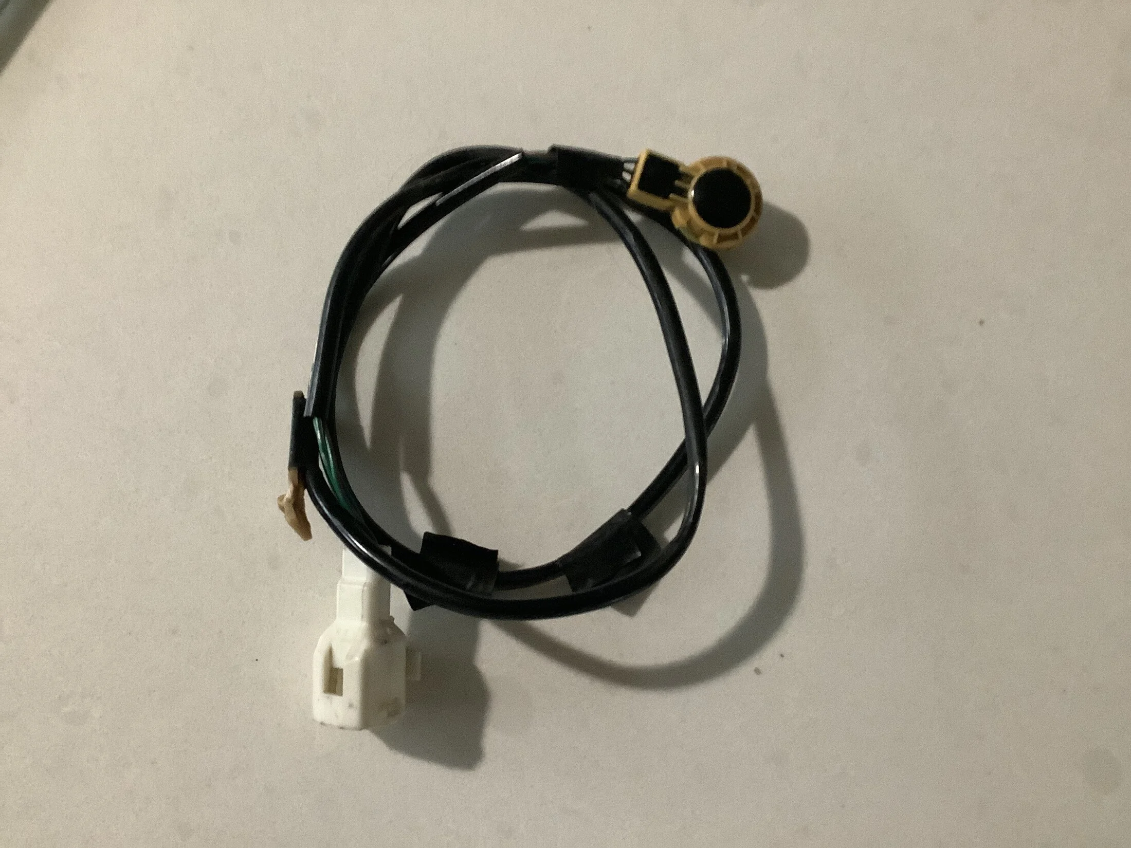

1. Alarm sounds while unlocking drivers or passenger door manually with the key. I replaced both door actuators. While in there I found another sensor not installed on either door. The sensor was just hanging loose on both doors. What is this sensor and where does it go? Are they available anywhere? I believe this is why the alarm is sounding.

Those are the door lock key sensors. I believe it determines the position of the key lock and is located right behind the key cylinder.
Thanks for the reply hoser. I have found part numbers for the door lock key sensors. Now looking for availability..

Hey tkbsurf, can you send the part numbers for the sensors. I’m having the same issues.
